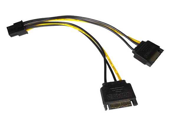

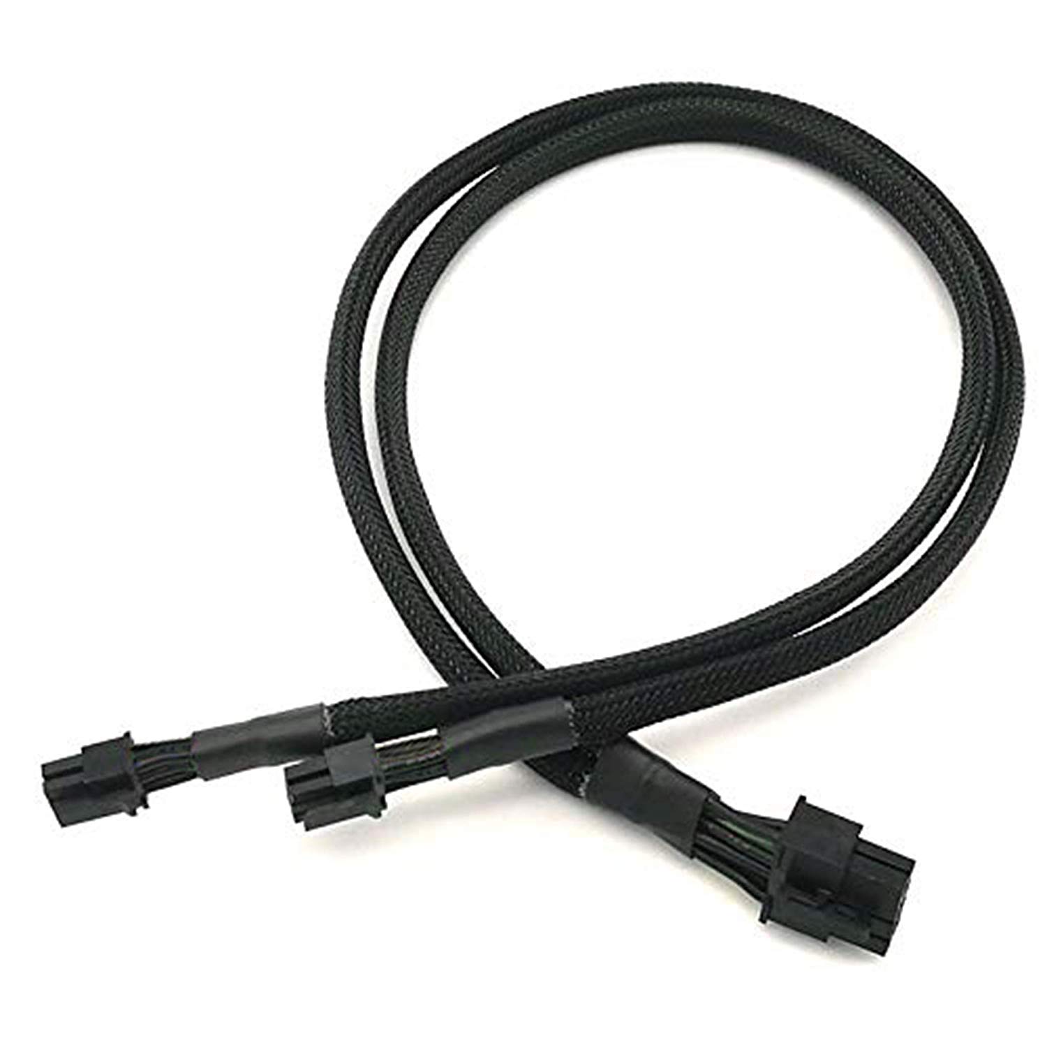

These are the correct cables to power your 7970 if it has an 8 pin and 6 pin socket.
TWO X SATA to ONE x GPU 6pin
( You will lose two SATA hard drives in the main case but if you removed your DVD drive you can put those drives in that vacant space
TWO x Mini 6 pin to ONE x 8 pin to GPU socket

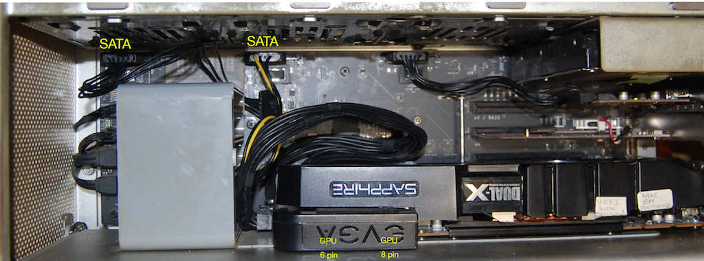

My Sapphire Dual-X HD 7970 3gb powered with the above cables via an EVGa PowerLink
EVGa PowerLink https://www.amazon.com/EVGA-PowerLink-Support-Founders-600-PL-2816-LR/dp/B07QLF9KNG
The PowerLink was designed for Nvidia GPUs but works on AMD cards too. I use a PowerLink with my MSI RX 580 8gb and also the Sapphire Dual-X 7970 ( spare GPU ) .
Everything works.
