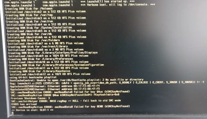

Just put the HD5770 into a 1,1 and booted with Lion. Same behaviour. I see the gray Apple, I see the spinning wheel and after that boom, no display output anymore. Given that I see this behaviour in the 1,1 ánd 3,1, could it then really be the lack of storage that prevents these Macs from booting?
Used this USB stick on the different 1,1 - that worked fine. That's one of the 1,1s with the 7300GT.
This is the last thing I see before the Mac shuts itself off. I have done the SMC resets.
