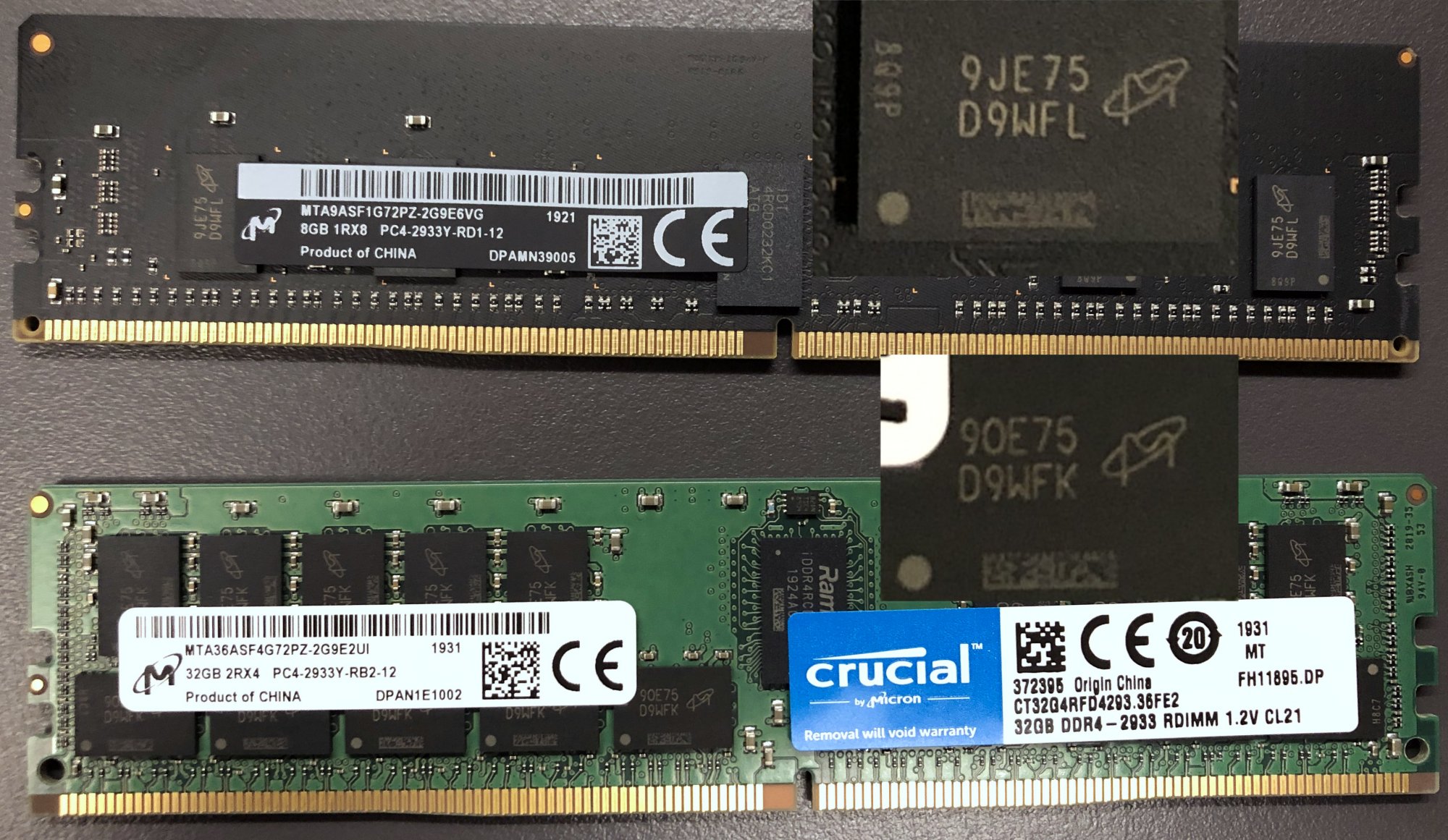

Do you have pictures of the third party memory modules you installed that you suspect are causing System issues ?

her'es the picture of both modules, of course gray being Apple's supplied, with the chips enlarged.
you did not see the difference?
first is a 1R8 and second a 2R4
but if it works, ok
hope also when it is fully used
I never mixed different types. I just bough 192GB of new crucial RAM and didn't use Apple's. Then after 10.15.3 it didn't boot with only the new RAM. it's solved now.
