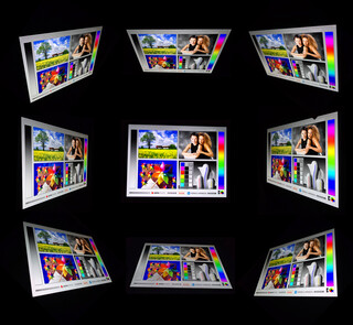

According to Notebookcheck, there is not much shift, at least with their eyes with their 11”.
As the panel can come from two different manufacturers, the tests can only be trusted to a limited extent.
Colour shimmers caused by reflections are not part of the test, but only the colour fidelity when the viewing angle is changed.
Compared to an OLED TV, the colours on the iPad pro M4 change significantly at an acute viewing angle.

This is what was tested but i guess this is not what Lexicon44 meant.

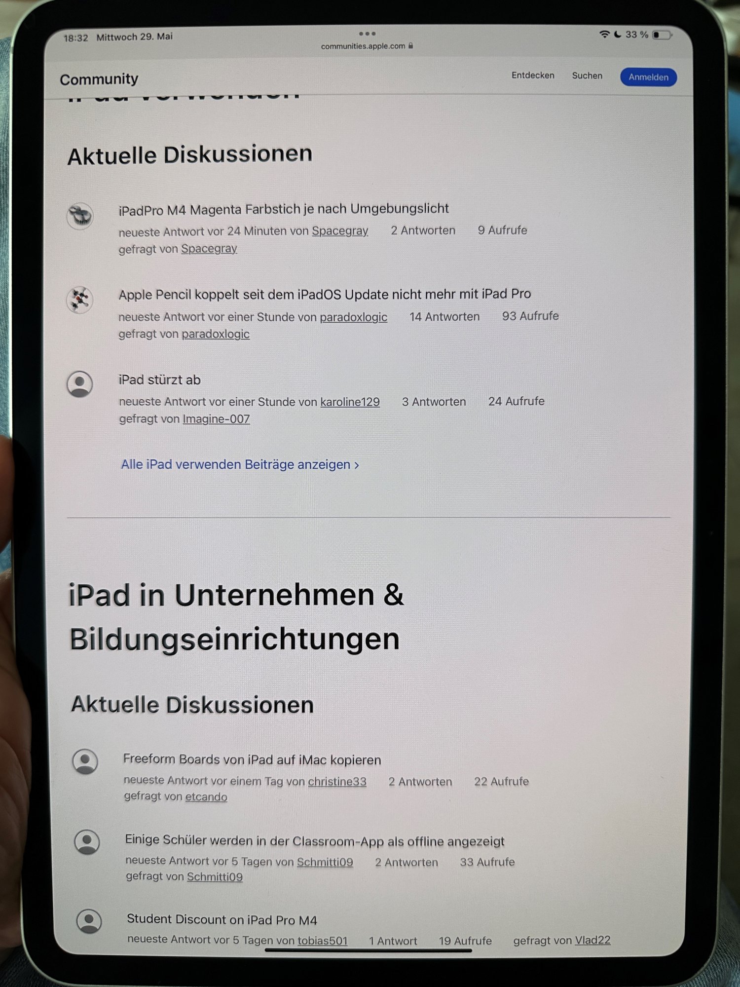

My device had this hue (location varying by viewing angle) and may be this is also Lexicon44's issue.
I hope, you can see the hue on your screen.

Aren't you looking at the iPad straight on in this picture? If so, that is definitely different from than what the OP is talking about.

This is very similar to what I was seeing. In this image I see a sort of neutral / blueish sweet spot in the centre and a reddish / warmer hue above and below.
Imagine titling my screen some 15-30 degrees back or forward causing the reddish hue to creep from below or above into the neutral area I was focused on and looking at dead on.
Tilting the iPad farther back toward 90 degrees had the entire display become a little dimmer and turn blueish.
This is all probably normal. I had a look at iPads at Best Buy and they had similar behaviour albeit much harder to spot under bright lights. Indeed, mine was also harder to spot with pot lights overhead turned on to max.
It also seemed less noticeable with truetone and night shift disabled, but even then there was a very slight hue shift.
Spacegray did an awesome job capturing this in the photo.

This looks like a bad-quality panel. OLED panel manufacturing is to some extent an analog process, and panels like that (or worse) occasionally come out of the factory. Threads like this one have been a regular occurrence for iPhones.
It’s also true that for the same model, panels from different manufacturers can have different characteristics regarding off-angle color and contrast shift.
