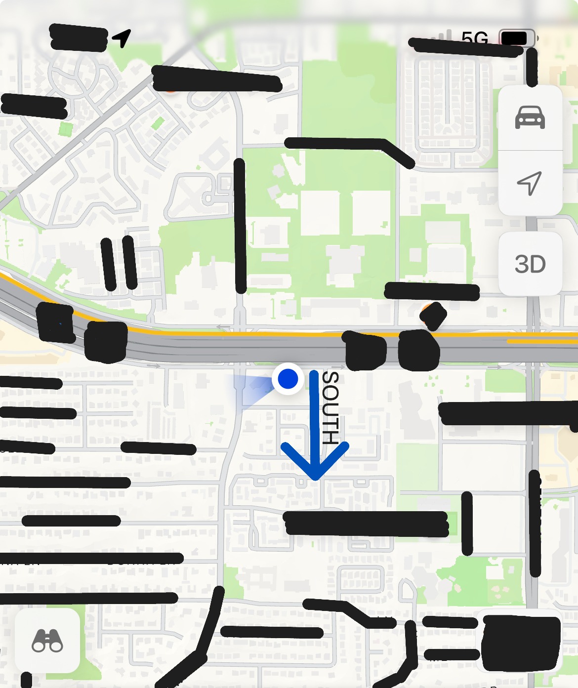

Example below (I have my phone pointing straight south). Even the regular Compass app reflects this discrepancy. Sorry for the markups, didn't want to give away any location details! 😨
