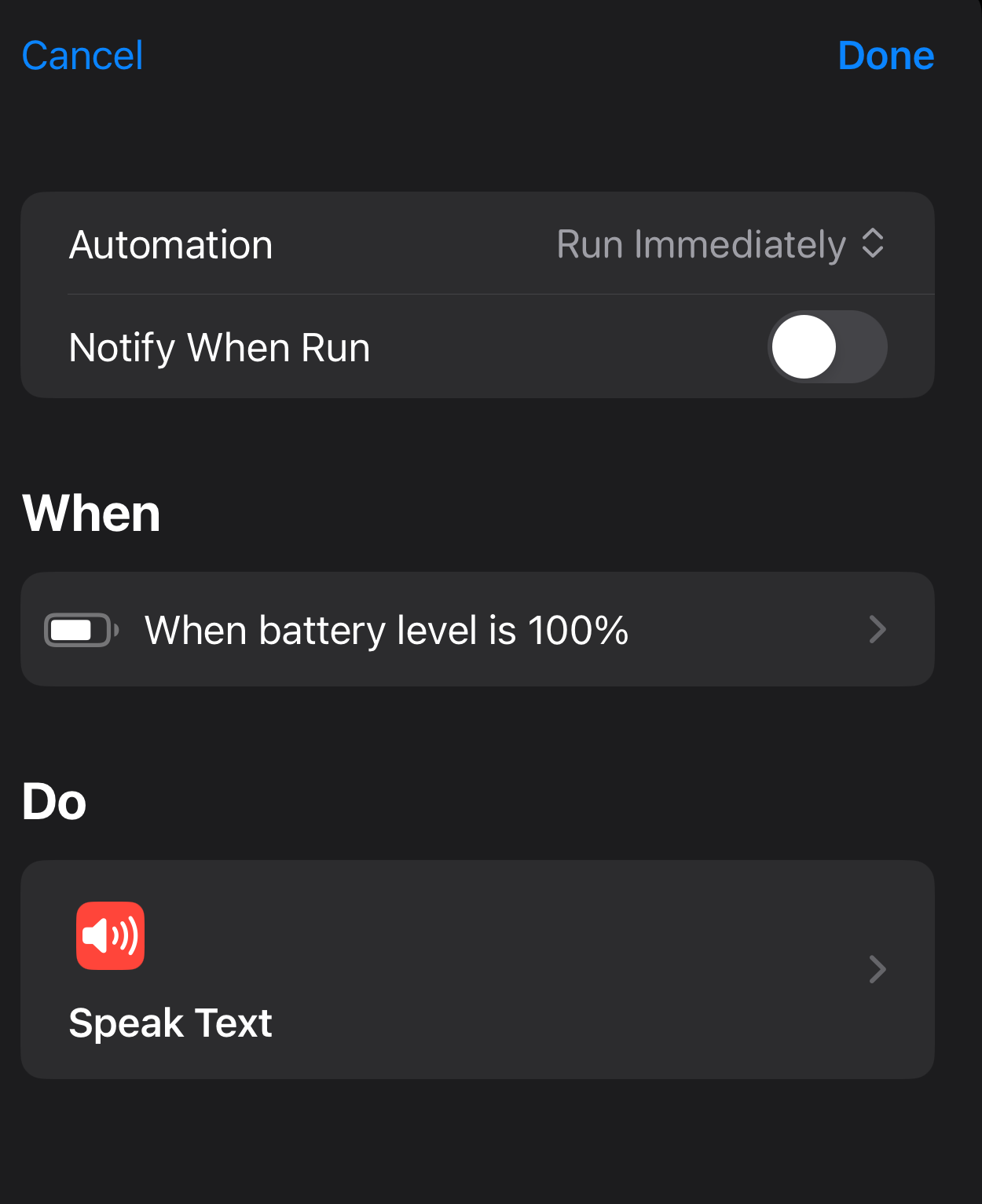

I had a shortcut / automation set up where I would charge my iPhone, then Siri would say "Battery Charged" when it hit 100%. That worked great for well over a a year and 1/2. ( created using this YT video -
After updating late week to iOS 17.3, it seemed to break it, smh.
I see the shortcut, automation is still there, but no voice from Siri. 🤷🏻‍♂️

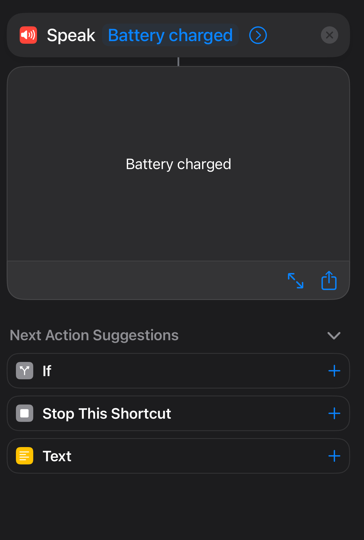

Thanks. I deleted it and started over. Ok this is absolutely baffling. I screen recorded this as I did it...tested the sound on the phone and heard nothing. (Volume is fine, not on silent mode)
But on playback of the screen recording, you can hear Siri say "battery 100%" Bizarre!!

**Update: Nope. Deleting the shortcut and redoing it did not work. No sound from Siri and also no notification when battery charged back to 100%.

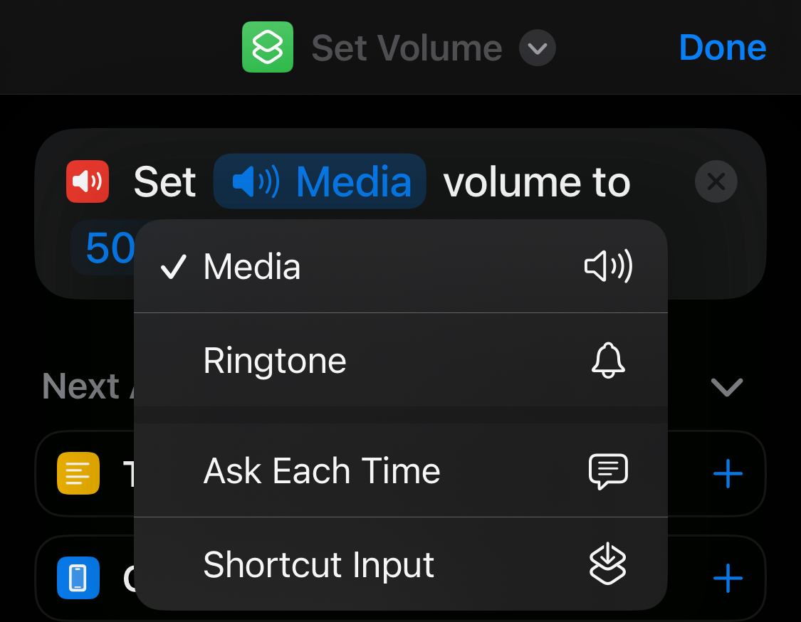

Something new in 17 iirc (maybe 16) is that there are now multiple volume options in Shortcuts. So, as a quick and easy test, might want to create a single Shortcut to set the media and ringtone volumes to some non-zero value. Run it and delete it and then test the Siri Shortcut to see if any change.
Wow, thanks. It is an audio setting issue. I can hear Siri if I put my phone up to my ear. Just have to figure out how to get it back to play through the iPhone speaker.

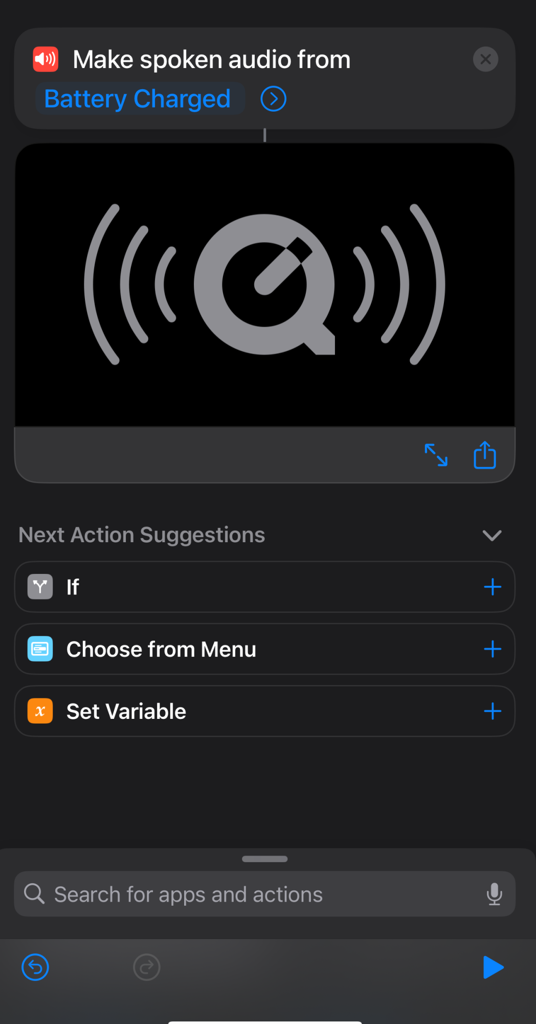

This seems to work now, I had to change the command from "Speak Battery...." to "Make Spoken Audio from...."
Something got changed, goofed up after the 17.3 update, no idea. At least it's working again.
