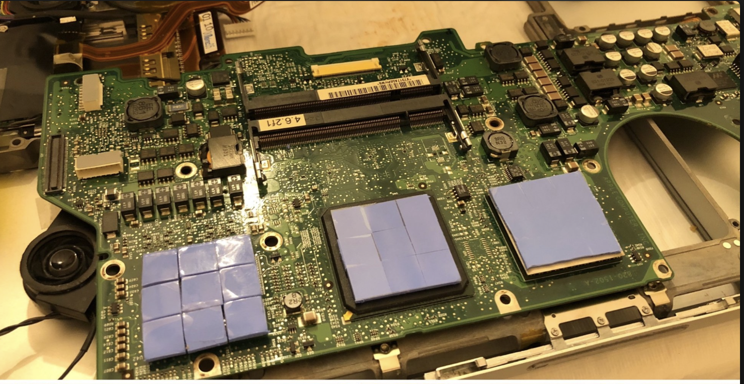

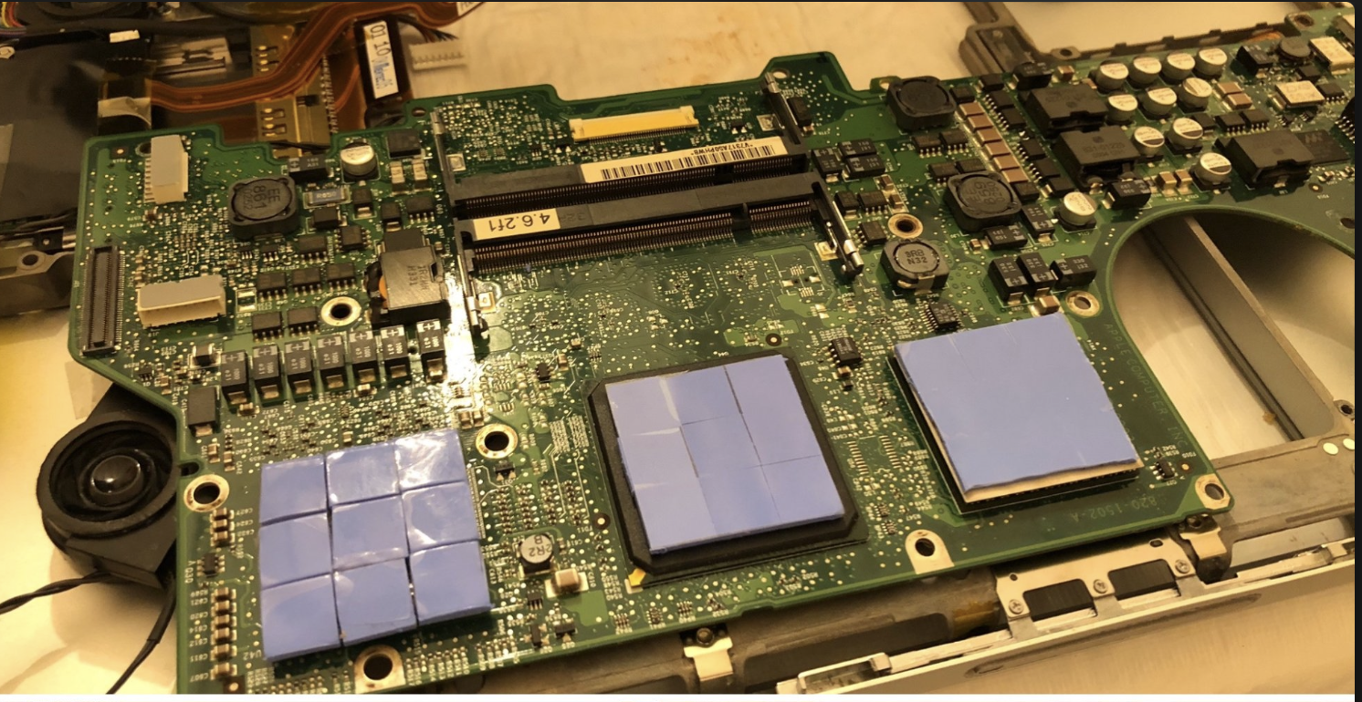

I am the odd man out here :) . If you feel you have the wheelhouse to safely disassemble your powerbook to repaste and replace the thermal pads, my opinion is to absolutely do that. Just take your time and you'll be fine. 20 years is so outside the life span of both thermal paste and pads, not replacing these heat dissipation elements creates risk with such an elderly machine. That is to say that with such an elderly machine, components do in their own way become brittle, so taking the time you need to safely disassemble is key. Do not rush. Take your time, be methodical and you and your Mac most likely will be fine. One caveat is that after 20 years the logic board will have glued itself to the heatsink/frame with the thermal compound Apple used - to get it off, hit the back side of the case where the heatsink is or the logic board behind those ICs with your blow dryer on high for a few minutes. This will soften the now glued on thermal compound that was used. Both my 17s were this way and needed to be heated up in order for the logic board to be separated from the heatsink/frame. What I have done on the last couple machines is used thermal pads in place of paste as the life span of a thermal pad is typically better and in my mind, easier to get off/apart. Happy to report that thermals have been great post-switch to pads.
I forget the pad thickness I used but will repot back (have to go check what I have) Another step I recommend is that you use an ice cube tray to keep track of all your screw/disassembly steps, review disassembly steps via fixit.com or some of the videos on YT and take plenty of pictures. Best of luck to you either way you go. :)
