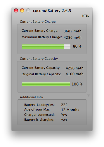

Here, to back-up my claims I'll show you my battery life:
