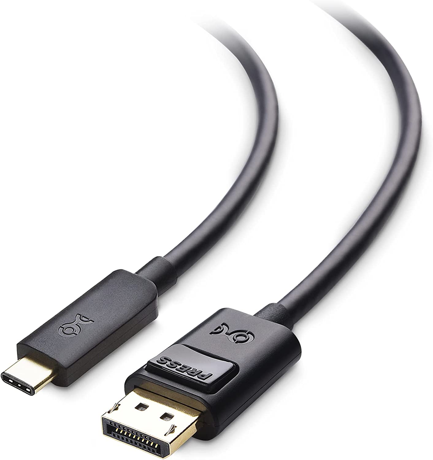

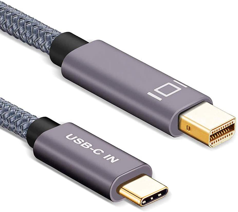

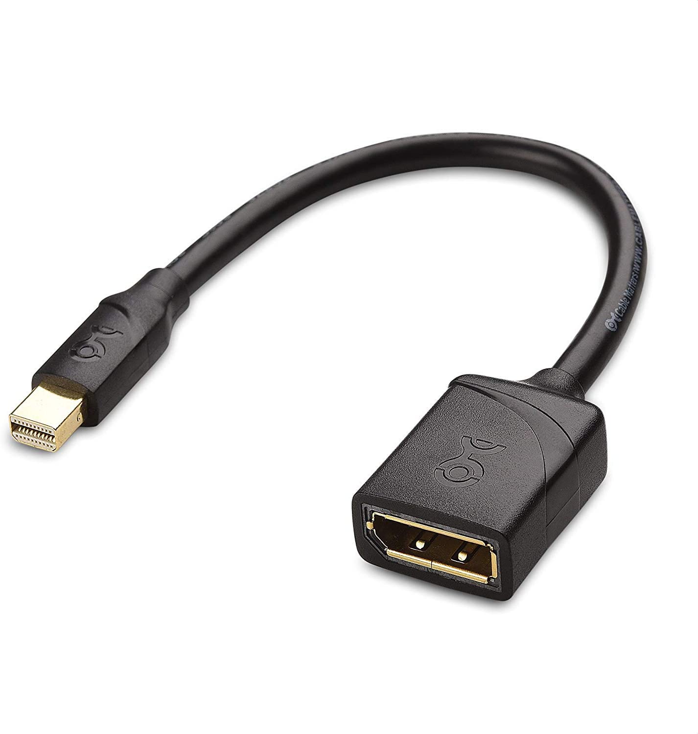

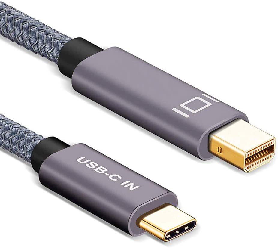

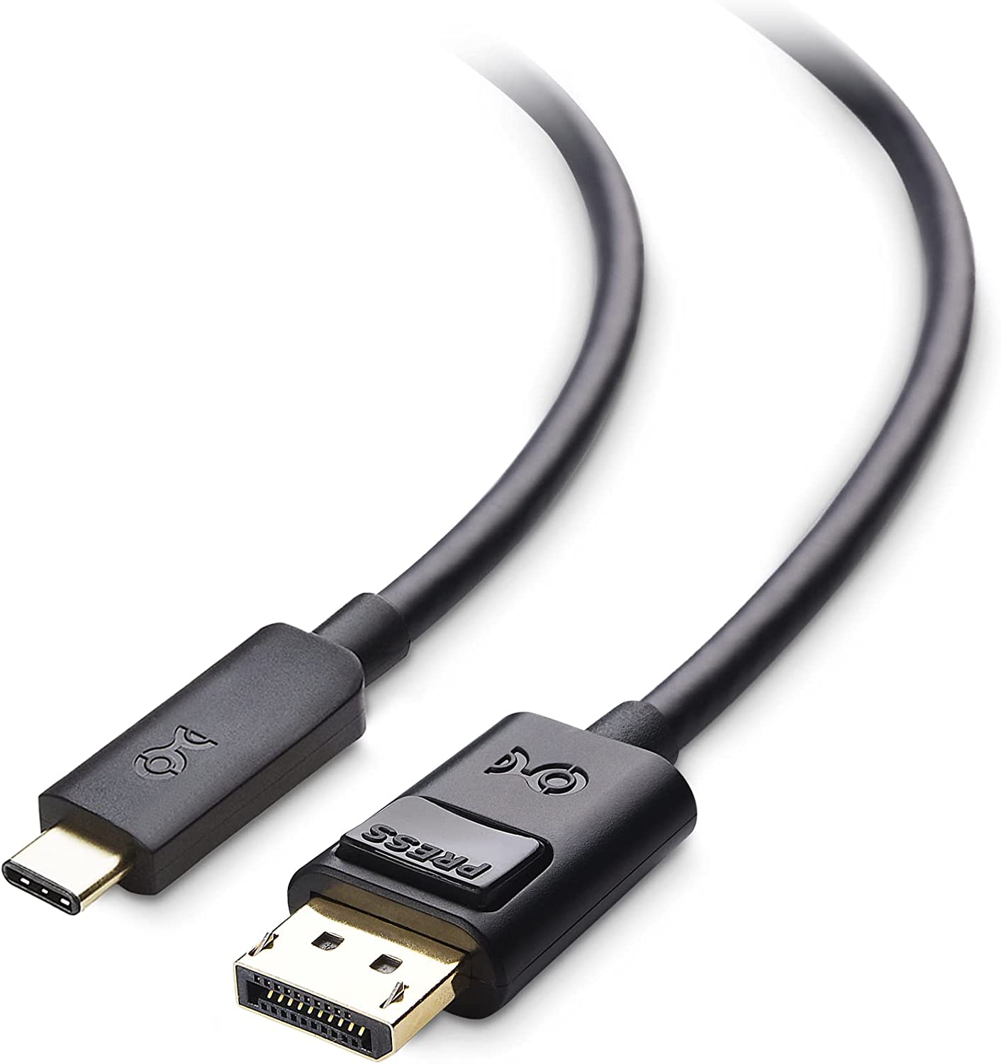

Hi All,
I have an 2010 iMac 11.6.8. iMac (27-inch, Mid 2011), and M1 Macbook 13-inch, 2020.
Can i use iMac as a monitor by using the cable picture i attach below?
Sorry i'm confusing between those thunder bolt/mini display port .
Hope can get answer from you guys.
Thank you in advance for your help.
If the cable below not work, can help to give me a link about what cable should i buy?
So easier for me to look for similar cable locally.
That cable will not work with either.
If it is a Mid 2011, then no cable will help you. The Mid 2011 iMacs are capable of Target Display Mode, but only with other Intel Macs with Thunderbolt. Not the M1 and up Macs.
Target Display mode will work on the 27" Mid 2010 iMac connected to an M1 Mac (or any other device, Apple or non Apple), as long as the source device (M1 Mac) has an DisplayPort output. The M1 Macs do not, but it can with a USB-C/DisplayPort adapter. You would then connect that to a DisplayPort to Mini DisplayPort adapter, and connect that to the Mid 2010 iMac.
For devices that are not capable of outputting DisplayPort (such as game consoles), an active HDMI to DisplayPort cable *MAY* work, but I never have tried and never knew anyone that has tried it.
Reactions: Misheemee

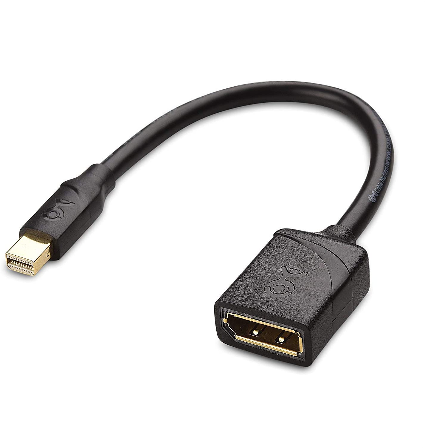

Juicy Box
macrumors 604
Sep 23, 2014
7,580
8,920
Or Juicy mean i need 2 things?
1. Thunderbolt 3 USB C /DisplayPort Cable
2. Display port/mini display port cable?
It depends on what you have already, and what you have access to.
The ideal solution is if you can get a USB-C to Mini DisplayPort cable, then you just need that. This is an example:
If you have a USB-C to DisplayPort cable, you will then need a Display Port to Mini DisplayPort adapter.
and
But again, this will not work a Mid 2011 iMac.

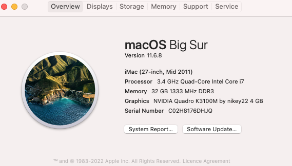

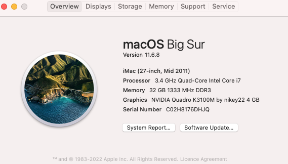

Look like mine is 2011 iMac.....so it's got no way to use as M1 MacBook monitor, right?

Post what iMac you have.
You mention both a 2010 and 2011 in your posts, and you can only use the Late 2009 and Mid 2010 iMacs as a display using Target Display Mode with the M1 Macs.
If you have a Mid 2011 iMac, then you will not be able to do any solution for Target Display Mode. I just don't want you to start buying cables and adapters unless you know your iMac is capable of what you are trying to do.
Juicy Box
macrumors 604
Sep 23, 2014
7,580
8,920
Yeah, at least not with Target Display Mode. Even if you had a Mid 2010, I am unsure if it would have worked since you have a non-OEM GPU.
Not as good as Target Display mode, but you can use Screen Sharing, it is built into the OS. I use Screen Sharing daily, with many different Macs, but mostly my headless ones.

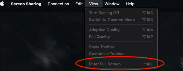

Hi Juicy,
Thanks for help me save those cable money.
I know screen sharing, but do Juicy know how to do full screen? I try many way but it cannot open as full screen…
Juicy Box
macrumors 604
Sep 23, 2014
7,580
8,920

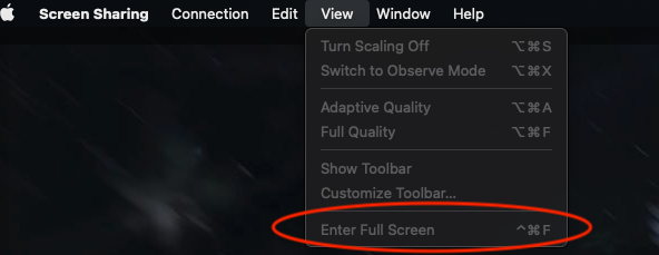

It is under "View" on the menu bar, and select "Enter Full Screen":
To exit full screen, you hover your mouse at the top of the screen to get the menu bar back.
Screen Sharing is definitely not a perfect solution, and is horrible for stuff like gaming, but for a lot of productivity tasks, it works great.
To increase the quality you can go to View on the menu bar and select "Full Quality", but this comes at the cost of increased latency. You can use a wired internet connection between the devices to reduce the latency.
I tried.
But it cannot full screen as 27 inch, it’s maximum like 21 inch, then the rest area is black color
