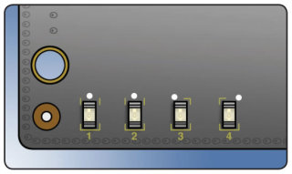

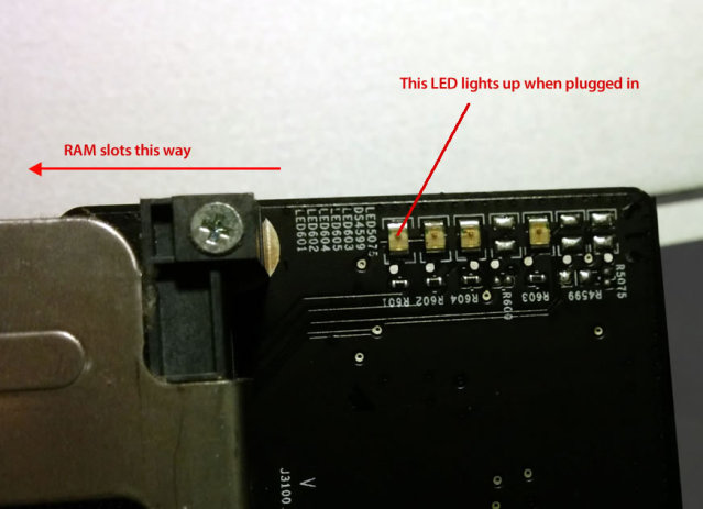

There is only one diagnostic led lit on the logic board (labelled LED601) when the iMac is plugged in:
There are 4 LEDs in total and it's the led furthest from the board edge that lights up. Strangely the service manual for this model seems to list the LEDS in an opposite order to my board:
I assume the LED that is lit up must be LED 1? ( indicating that trickle voltage from the power supply has been detected by the logic board).
Does this mean that it's most likely a logic board fail? why would the logic board suddenly fail overnight when iMac was sleeping?

Yeah I understand that… I'm not complaining, I'm just trying to diagnose what component has failed.
I'm thinking it must be the logic board unless anyone else can offer some suggestions? I've actually sourced a used logic board from a 2009 core i5 iMac complete with CPU so I'm going to see if I can resurrect it with that. If it works it should also be a nice performance boost too compared to the Core 2 Duo it currently has. Heck if it works I could even potentially stick a 2011 model i7 cpu in there to really extend it's life some more! It is already a bit of a frankenstein as it has a 2011 GPU (6770M) and SSD 🙂
