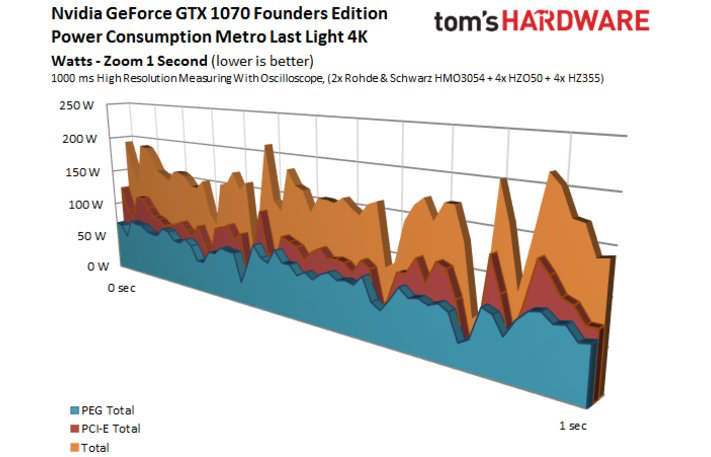

Quite sure you can use only one mini 6pin to power the reference 1070's 8pin. It's a 8pin, but it won't draw anything near 150W. So, it should be OK to install dual reference 1070 even without Pixlas mod. But if you don't mind to do the mod, better to go with it.
