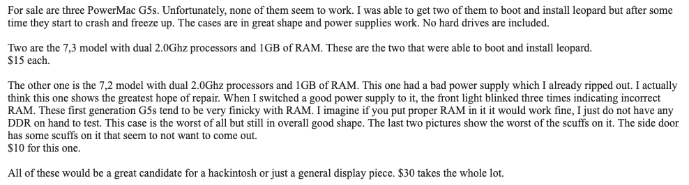

Hi!
I've never owned a Power Mac G5. I have some limited hardware repair experience on other tower Macs, but nothing drastic (I haven't replaced a power supply, for example). I came across this ad on Craigslist today. I was wondering if any of these 3 G5s are worth picking up to get 1 for myself, or if I could fairly easily (and cheaply) repair and/or sell the others, or if I should just skip them.
Here's a photo of the listing description:
The guy is also selling a G4 Quicksilver, which is one model that has eluded me so far, so I might get that at least. Any help is appreciated! :)
In my experience it's hard to determine what's at fault. Maybe try burning a CD and booting into Apple's Hardware Test to see if that helps.
Aside from nostalgic value is there value in fixing them? You can probably get a working model from Craigslist instead (I have two G5's laying around in working order from CL, not hard to get for $40ish each) and sell these for parts online or use the cases for hackintoshes.
For $30 just get them, you can't go wrong at that price. The only PowerMac G5s known to have catastrophic issues are the Liquid cooled ones, which these aren't. They are, as the post says very picky with ram. It's most likely the cause for those other ones. Even if it is the proper ram installed, the sticks could be faulty. Most "untraceable" problems end up being RAM related. DDR is pretty cheap and easy to come by too.
I believe these models are prone to a problem where the memory controller fails to make reliable contact with the system board and therefore gives the appearance of memory errors (when this happens the power light flashes three times no matter how you configure the RAM).
A quick and dirty test is to push on the memory controller (it's the big chip to the right of the memory slots and the left of the CPUs) while powering on. If this is the problem it might boot (this is by no means a conclusive test).
If this is the problem the only solution is to replace the system board or re-ball the memory controller (the chip is fine, it's the connection which is the issue).
I bet you could pick them all up for $15-$20. As to whether it's worth it only you can make that decision. Financially it's, IMO, a non-issue. The parts alone are worth more than the $30 asking price. The question becomes do you want to spend time messing with them?

As a DIY project, it's probably worth a shot if you like to learn more about the PowerMac G5. You can download the service manual here and I would highly recommend you to do so as it helps diagnose issues.
It looks to me like the seller had tried his best to fix those PowerMacs, so perhaps you may have better luck.
Unfortunately for myself, I recently adopted a PowerMac G5 7,2 which I thought was in good shape and used it heavily for close to 1 month. Then just yesterday when backing a DVD, the G5 froze and upon rebooting, I have no chime. Luckily I work in a recycling facility where I have access to a lot of spare parts and determined that the power supply or logic board is at fault, so basically I'm now waiting for a good donor. In your case, while it could be the memory controller, though for a 15-16 year old machine, is it worth your time to fix it and perhaps expect another problem down the road? I thought I had fixed and refurbed my own 7,2 with parts from other machines and it was working beautifully and stress tested for close to a month without problems. And yet while copying a simple DVD yesterday hardly even stressing the cores, the screen froze during the DVD backup and died. So is it worth $30 and your time? Only you can answer that. Do you want to sink in more money to fix an aging 15-16 year old machine unless you have a real pressing need for one and the parts you can buy out there are equally as old?
