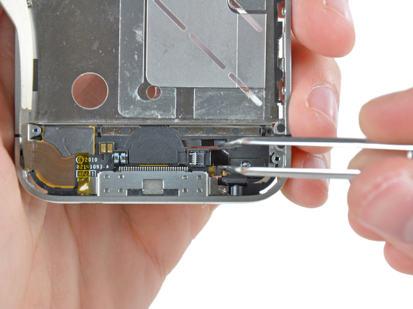

Home button feels good! I had to 'assemble' the home button. I had to stick the ribbon cable which has the actual button on it to the back of the white plastic. It was a struggle fitting the cable into it's holder.
vT1QoIFIGTAsxCms.medium
The socket the cable goes into is very thin and you can't force it.
There's a kind of a lock thing on top of the transistor where the little ribbon goes into. There's a little tab that you have to lift up to insert the thin cable and then push downwards to secure it in place.

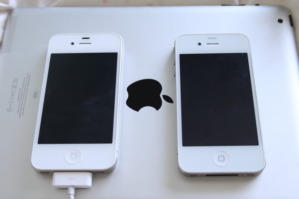

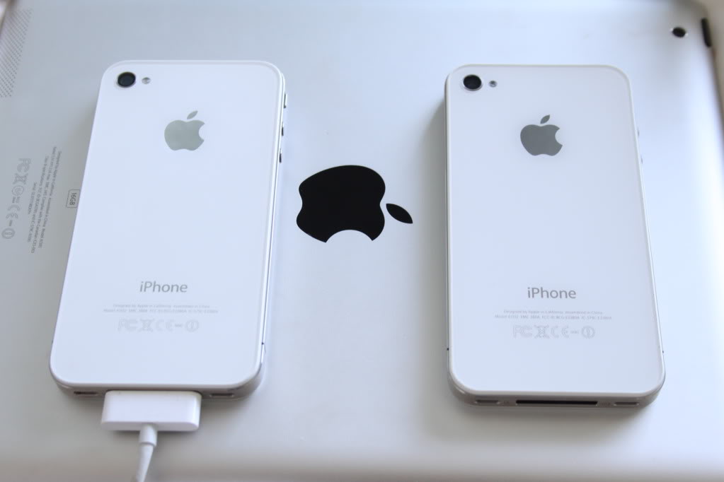

I have the genuine White iPhone 4 too. I got it the day it came out. I did this for my GF really, because she wanted a white iPhone but can't really afford one.

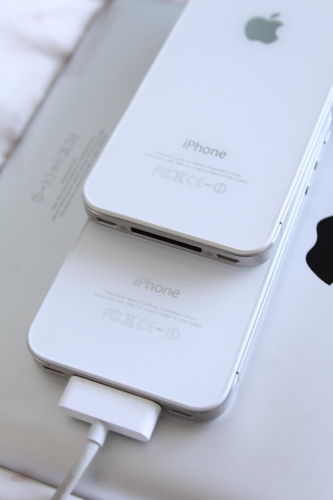

I will take a picture comparing the two for you.
Edit: Here we go.
Real iPhone is on charge.
What I'm trying to show you in the last image, but I don't think it's worked, is the fact the same model number appears on both rear pieces of glass. Am I right in saying the white iPhone 4 has a different model number to the black and it was recently changed close to launch?

Appreciate the pictures comparing the two. Virtually identical minus the prox sensor and home button. I am currently trying to find a beat up or cheap black on carrier Telus in Canada and convert it to white with parts. If this proves unsuccessful, I will purchase a factory unlocked white.
