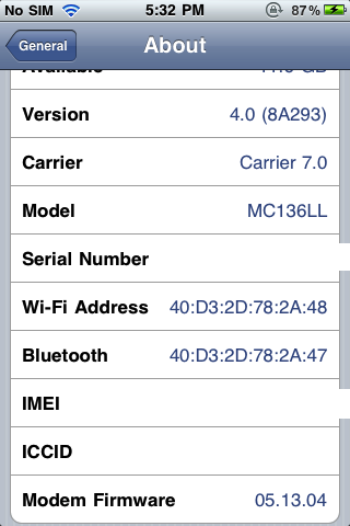

Seems these are the steps I should follow. I have PwnageTool downloaded and installed on my MacBook Pro. I was wondering what steps to follow to create the custom ipsw.

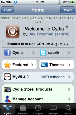

How do the saved SHSHs work? Attached is a screenshot of mine on Cydia which has SHSH information. I never knew what it was all about.
