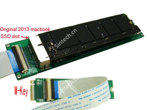

No boot delay in slot #2. Running the SSD7101a with the cover off is probably a no-go. The PCIe switch would burn up without a heatsink. For your SSUBX, SINTECH has a M.2 extension to Apple PCIe SSD adapter for $20 that should allow you to snake a PCIe 3.0 connection off of the SSD7101-a. (I need to try this)

Okay, thanks... I already bought/have the Sintech adaptor. It raises the height from the PCB so I figured the heat sink wouldn’t fit over it. Perhaps there is a different adapter I’m not aware of. If you can test yours before you sell off the SSUBX let me know the results.

Do you have this NEW product? Ordering one today, it's about $23 with shipping to the US from China. I haven't seen any resellers with this product yet.

I purchased this Adapter..

The adapter you have is the same one I had from years ago. It definitely won't work, even on the Afeltec it blocked the adjacent slot.
Okay, great news on the OOTB numbers. I guess this is the card I’ll get. When that other adapter you ordered arrives, let me know if it works. I need a transition solution until I can afford the 970. Medical expenses are dragging me down to a tight budget with no end in sight.
I'll circle back on the new Sintech Adapter when it arrives in three to four weeks. Postal service from china can take a while. Sorry to hear about the expenses. Hopefully the new adapter can help you bridge to the 970pro.
