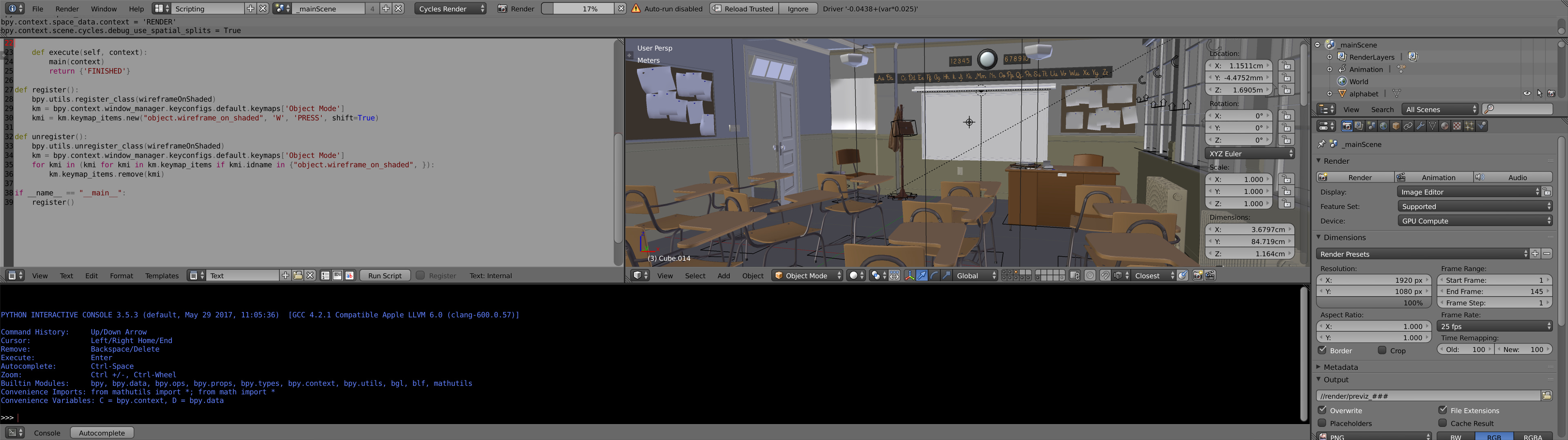

And here are some example of how the UI looks on my CHG90.

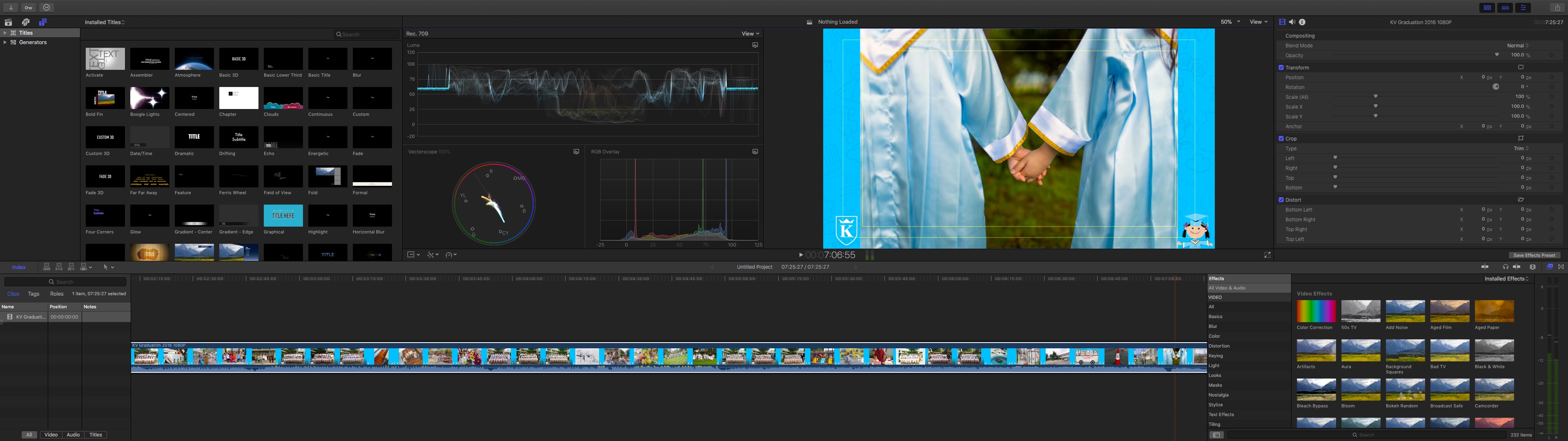

FCPX
Blender

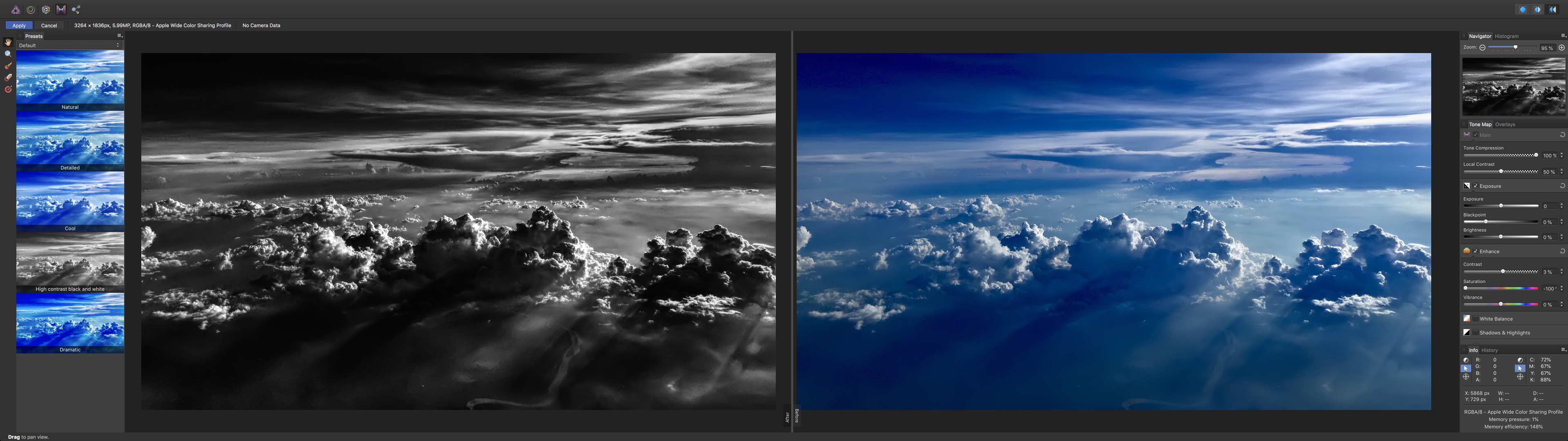

Affinity Photo

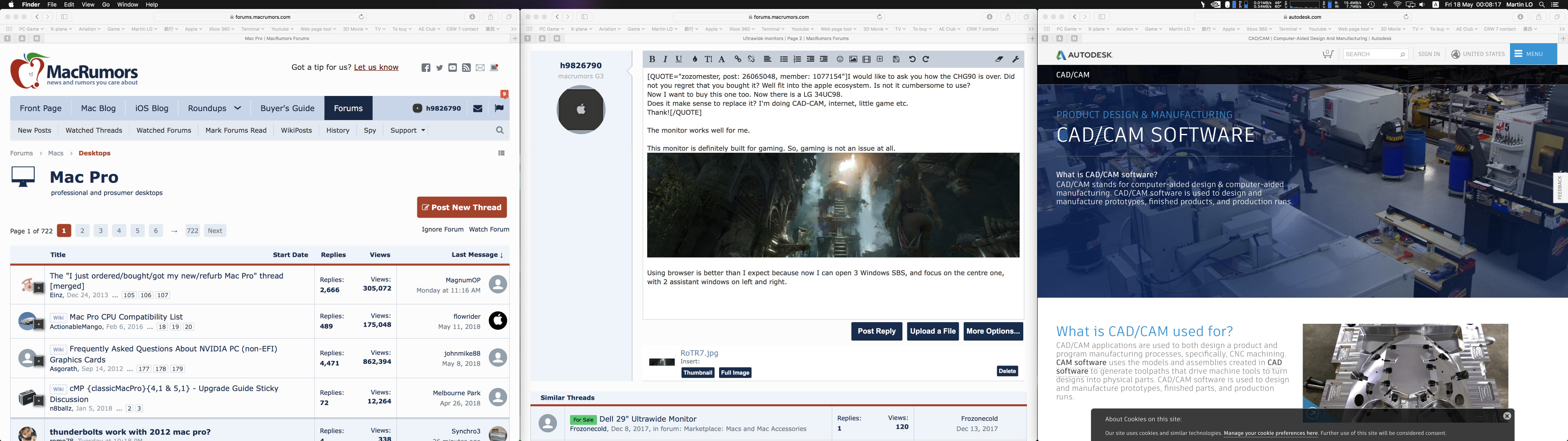

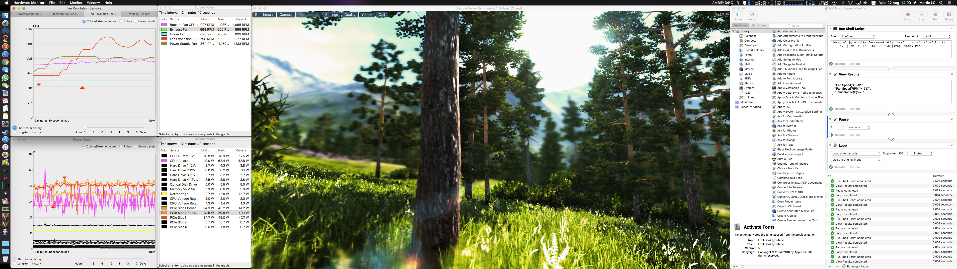

Other usage
