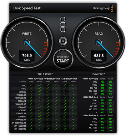

Just enabled TRIM and the video began directly become smoother, but still minor stuttering.
Here my Black Magic Disk speed Report.
The GPU should be fast enough for 4k. Bough

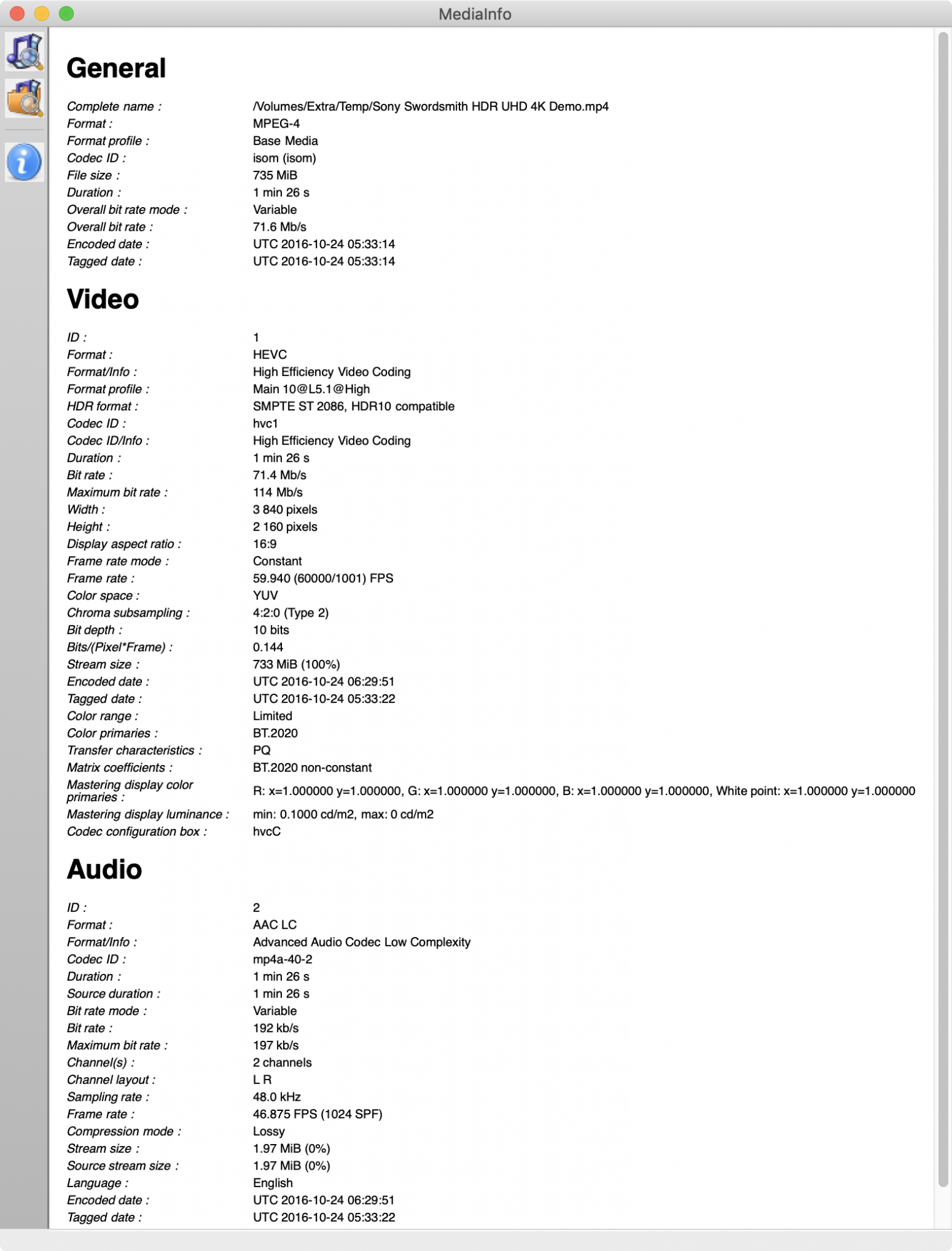

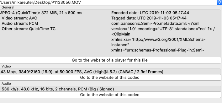

Hey - i think you guys misunderstood me. 4k is running well on Youtube, but not on my SSD. Seems, that my SSD might be too slow.
Best
Then you have to show us the video info. Otherwise, no way to tell what's wrong.
e.g. You can use the free version of MediaInfo

The 4k video playback (H264) does work on a mechanical hard drive too, because I tested it not long ago on a 2014 Mac mini...
The problem is your CPU/GPU, which cannot hardware decode HEVC/H265 files. That is while it is laggy.
The video he listed is AVC.
AVC is h.264, not h.265 HEVC.

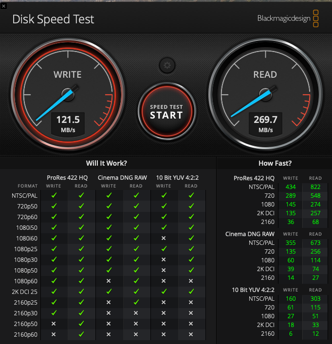

The 4K file I tested for "playback" was 4096 x 2160 Panasonic GH4.
Sitting on what now is a 4 spinner internal RAID 0
A. Hitting space bar-Plays Smoothly
B. MPEG Streamclip 1.9.2-Plays Jittery
C. Quicktime Player 7-Plays Jittery
D. Quicktime Player 10-Plays Jittery
E. VLC 3.0.7.1-Plays Smoothly
F. INA 1.0.1-Plays Smoothly
G. Avid 8.10 Timeline-Plays Smoothly
H. DaVinci 15.3.1 (CUDA CORES)-Plays Smoothly
In addition to the P GH4, I have Alexa, R3D, Sony etc. So yes, it depends on how the 4K is "played back"! :cool:
