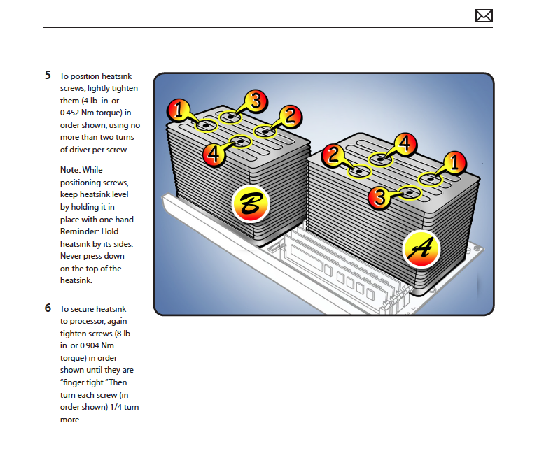

ActionableMango..I have a hex wrench pretty much like the one you use. Also, h9826790, I use arctic silver 5. Been using that for a long time. One question for you guys - on the removal of the heat sinks, you count the number of turns on their removal. To re-install, do you use the number of times for removal to re-install or should you use one less turn then adjust if necessary. For example: 6 turns for removal, then 5 turns to install, then adjust if necessary. I've tried to research this & have seen both ways used, so thought I would ask some guys that know.

^^^^For me, as I recall, it was difficult to count the number of turn, because the screws are buried so deep in the heatsink. I used my judgement when retightening based on Apple's specs (finger tight+).
Apples instructions are above.
Lou
I also never counted turns and tightened the screws until it felt right. I even did it this way when upgrading dual socket MacPro4,1 which use delidded CPUs.

On my 5,1 I just turned the screws until they stop. It's kind of hard to explain in words, but I'll try. A normal everyday screw gets tighter and tighter and tighter toward the end as if it were an analog process, but on my 5,1 screw tightening was more of a digital process like "easy easy easy easy easy stop". It's one more example of the many tiny little positive surprises I experienced with my 5,1.
So no, I didn't count anything. That's pretty much for dual-processor 4,1 CPU installation which seems to be super sensitive about screw tightness being perfectly even across all screws and also "not so far you just wrecked your sockets".

No need to be too complicated, my own experience is also finger tight is good enough. Something like turn the wrench until you can't do it by a single finger. Then add 1/4 turn.
That count turn method is mainly for other purpose.
