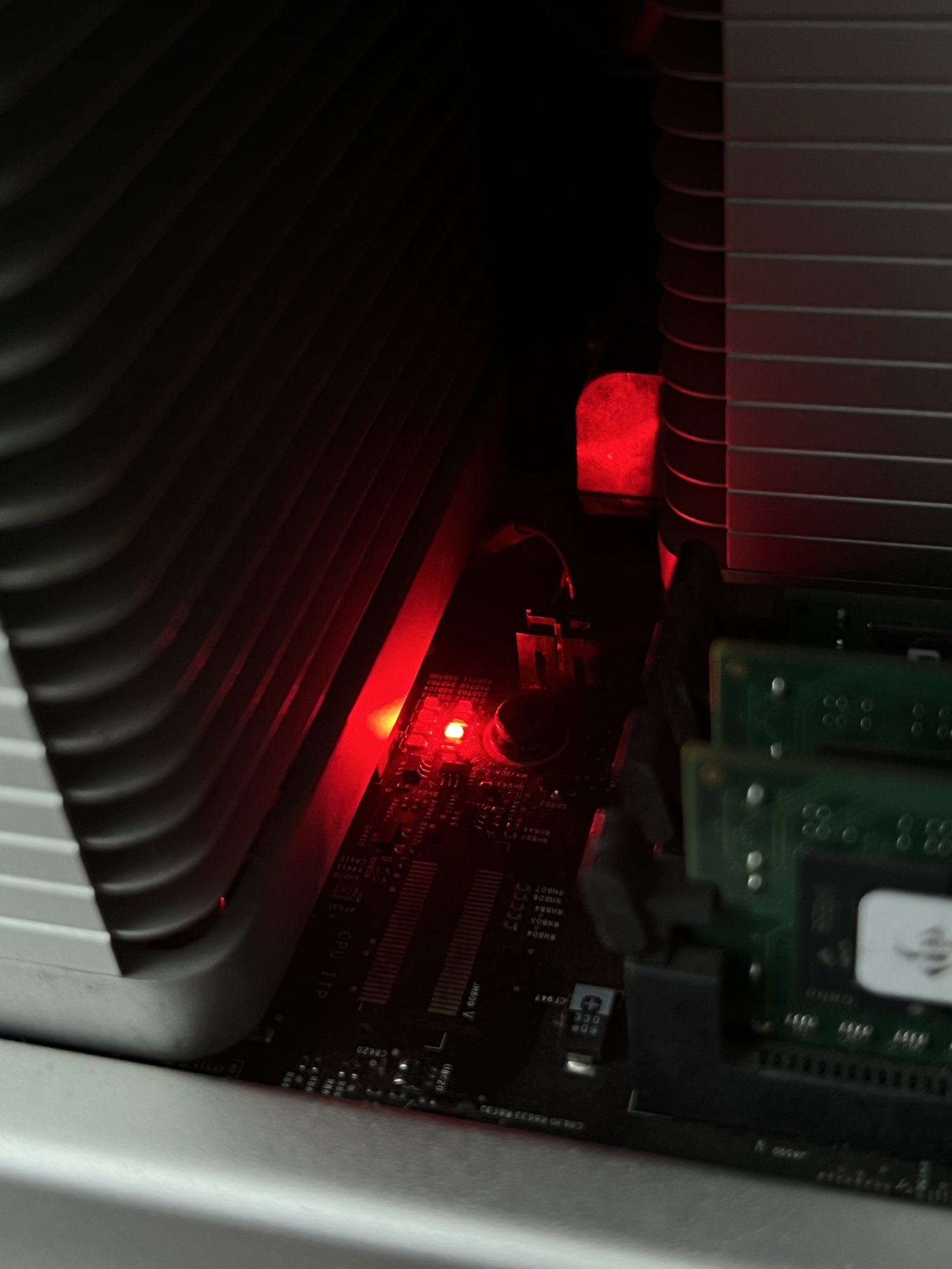

Graphics card and all hard drives removed, no chime. Although now after three or so attempts it stays on with a red light that hadn’t happened before. I’m assuming this is indicating a failure somewhere on the board?

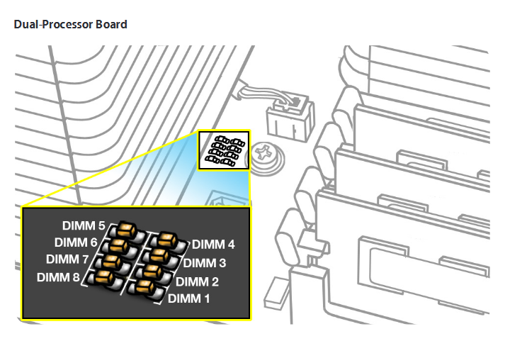

On the Dual CPU Mac Pro like yours, those are RAM memory diagnostic LEDs, so there are 8 small LEDs pointing to each memory slot. Check which exact LED is lit, and try Mac Pro without that memory stick.
Managed to get that light off by removing the RAM in the indicated slot but no change to the other symptoms.
