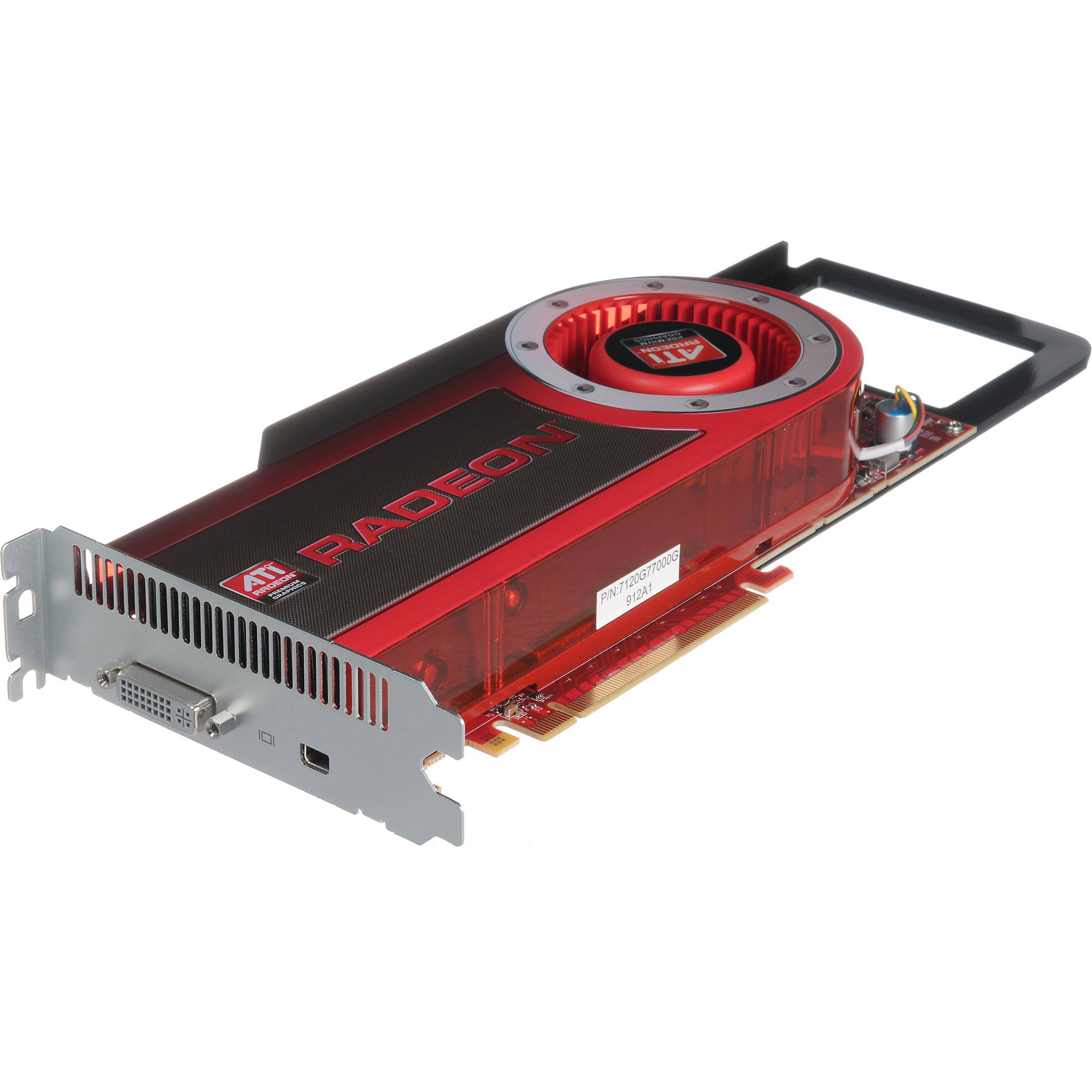

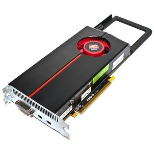

It was purchased through Apple as a refurb in 2010. I feel fairly confident it is a 4,1 but without being able to check the about screen, I cant be 100 percent sure. Opening up the side of the tower, it is an ATI Radeon GPU. I do have another monitor to test the GPU, and still get a black screen.
Does it look like this?
Well. Damn. So, where to from here then? I pulled our internal backup drives out of it and put them in enclosures to allow us to pull from them. Id prefer not to write the machine off if I don't have to, so do I need to get a new graphics card to proceed and then do a clean install or is there a better route to take?
