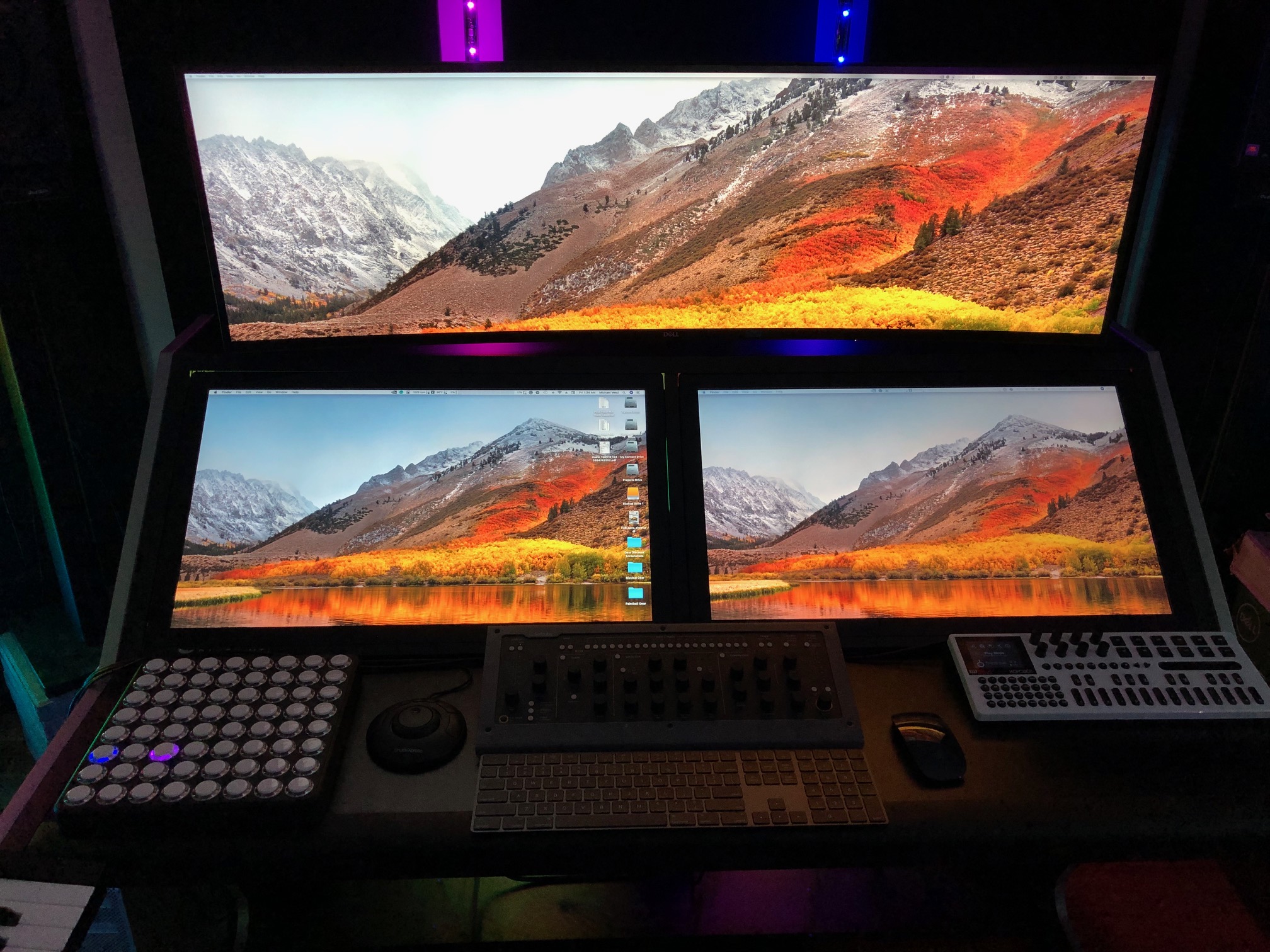

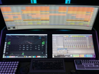

I was about to pull the trigger on the Samsung CHG90 but wasn’t crazy about the 1080 vertical resolution so I’m holding off for the updated model. I recently gave up two Apple 27” Thunderbolt displays to go with the multitouch Raven MTi2’s fitted in the Raven Core Station which looks like this: https://www.sweetwater.com/store/de...ogy-raven-mti-core-station-with-2-raven-mti2s
The Samsung monitor will fit perfectly across the top of this setup when using a floor standing mount while not being so tall that I’d be craning my neck upwards to work since it’s simply extra wide. The other monitor will be at a separate station in the room. I am going for maximum screen real estate since that monitor will sometimes have to fill the role of the other 3. I’m seeking information from people who may either have experience with the Quadro cards or who know enough about running multiple high res displays from a 5,1 Mac Pro. If, for example, someone knows that DisplayPort 1.4 will not be supported in the beta drivers for the Pascal based Quadro cards then I’d like to know that. Or, if only certain resolutions can be driven due to limitations in the bandwidth of PCIe 2.0 architecture (or whatever else).
Hopefully someone knows something. If and when you get all that set up and working, come back and post a pic here--I'd love to see it.
Dell ended up being the first to release a 5120 x 1440 ultra wide monitor and the Samsung will likely be a gaming version with more curvature when it's released anyway so I went with the Dell. Here's some pics of it with my two 27" Raven touch screens. The 4th monitor isn't shown since that part of the room isn't done yet and I plan on replacing the 31.5" 2560 x 1440 monitor currently residing there with a 40" 3840 x 2160 monitor after I get the rest of the equipment in place.
