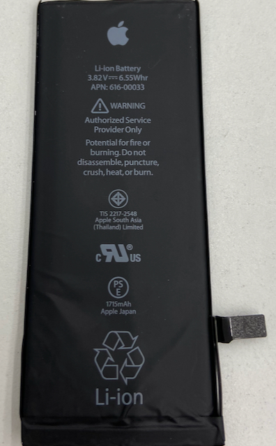

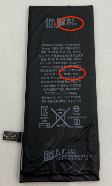

For anyone interested: this is the battery that emerged from the iPhone 6s. It appears to be Apple original, date stamped 2013. Quite peculiar as this model was announced in 2015.
