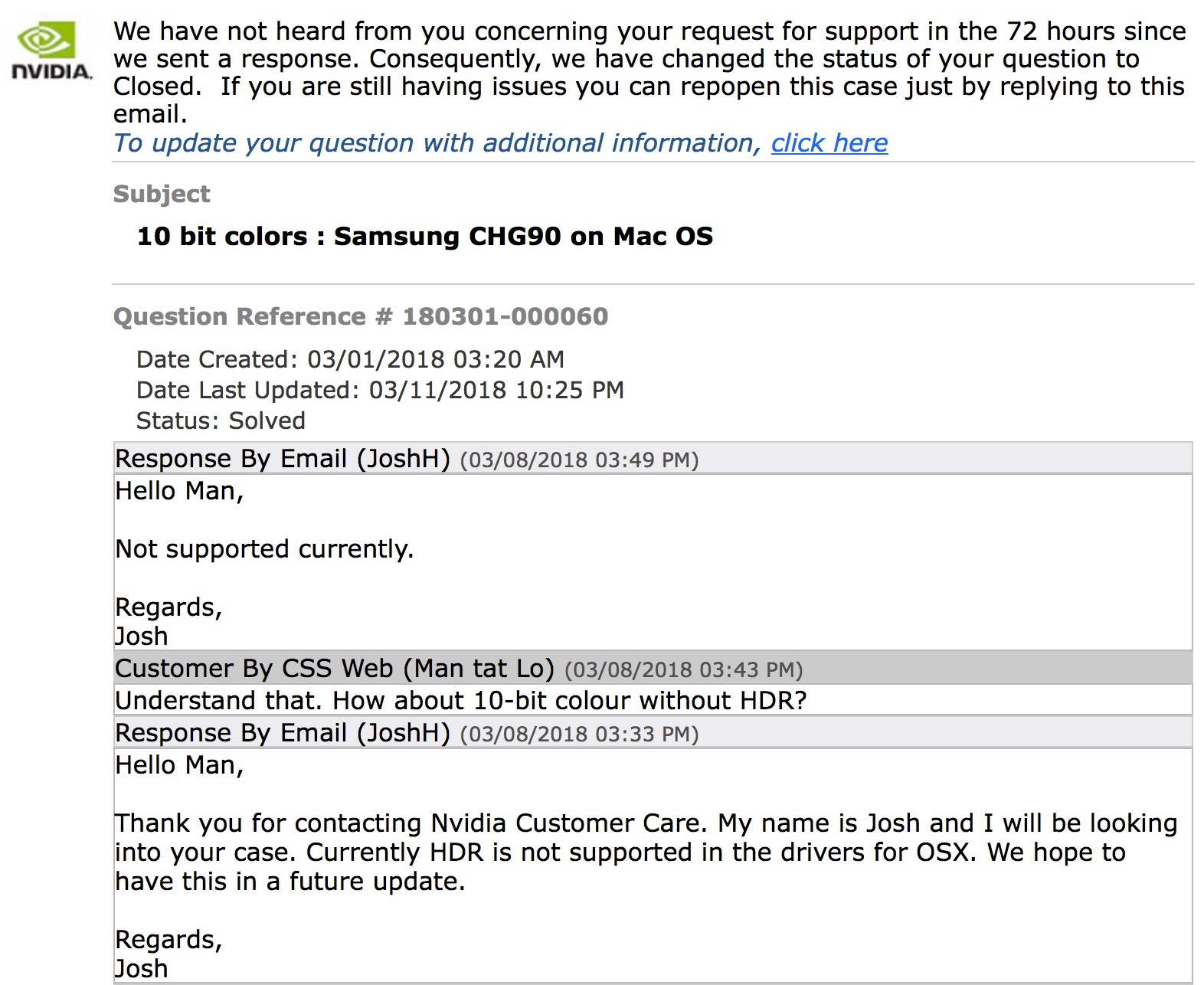

Im using gtx 1060 6gb but do I need a workstation GPU like Quadro P2000 to get 10 bit color support?
Even though 10 but colour may work, but Nvidia said currently is not supported in their macOS driver.
For your info, I am using 1080Ti.

So how to use a 10-bit color monitor?
You don't have driver support in Nvidia and only latest AMD cards from Mac Pro 2013, Polaris and Vega support it in drivers.
Creatives and print industry has been using 8 bit and 16 bit images on Macs without 10 bit support for many years. You will have an 8 bit output with dithering. Professional level monitors have up to 14 bit internal processing and calibration settings to help you tune the display.
