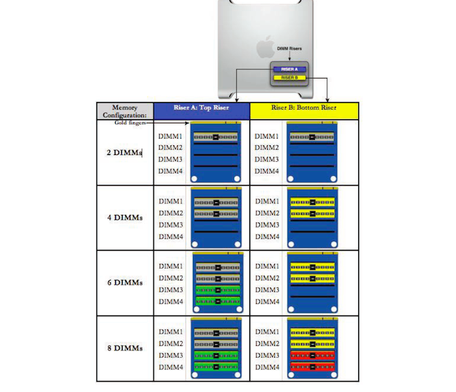

Is this a dual processor system? Perhaps one of the processors has failed resulting in its memory not being available? How are the DIMMs allocated on the riser cards?
The 6 DIMMs are installed as shown in that ^^ picture.
The weird thing is that I reversed the riser cards, and changed the DIMM config, and no matter what I did only 2 GB reported. 10 year old computer, so not really all that surprised, but ...

Specifically how did you change the riser cards and DIMM configuration? Was there ever a configuration where you had four DIMMs in the lower riser? Have you attempted to test all of the DIMMs by using a two DIMM configuration to ensure you have 2GB for each pair?
