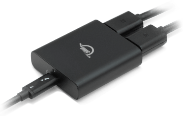

Interesting, thanks.... Since I posted I found this:
...and am thinking to combine it with two of these:
which in theory should work and only use 1 port on the Macbook.

Yes that is true. And a TB dock would solve that issue. But I can connect USB-A using a hub I already have. I just find TB docks are very expensive.
If you want two displays in one port you need Thunderbolt. MacOS doesn't support MST so all the cheaper USB C two display options will only allow both monitors to be mirrored and show the same content.
I just bought the OWC dual TB adapter for a great price used off Amazon, will report back if it all works, thank you.

Just coming back to confirm that this worked very well.
