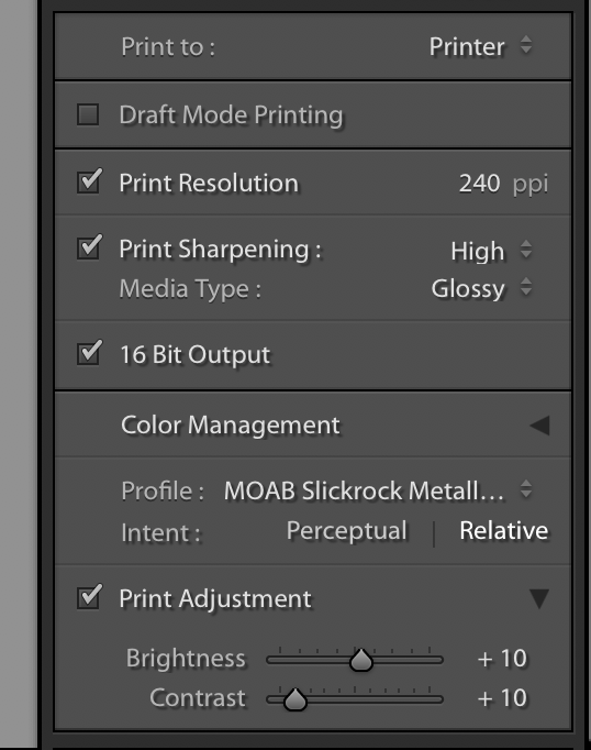

I use my P3 5k iMac to edit and print images that my camera captures in AdobeRGB. I set up my Canon Pixma Pro 1 printer with the ICC profile of the paper I will use. Then I tell the Lr's print module how to handle colors outside the sRGB color space..Perceptual or Relative.
