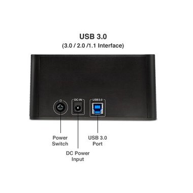

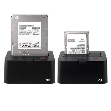

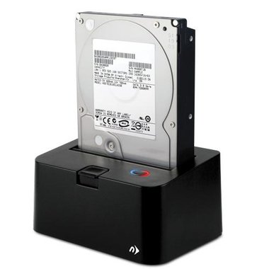

Is it this? "
Newer Technology Voyager S3​
Mfr P/N: U3S3HD OWC SKU: NWTU3S3HD
  • Newer Technology Voyager S3
Use and swap 2.5-inch and 3.5-inch SATA drives with this USB 3.0 / USB 2.0 drive dock."​
If I get the drive out, I just stuff it in this dock and it should read it? Any special considerations? It will be my first time.
However, that link just opens the page: configure your own 15 inch macbook.
Posted in Safari on Mac. Link works in Google Chrome on Mac. Link works for me when pressing the link on my iPhone and iPad. Dunno what to say... ¯\_(ツ)_/¯
I tried it in Safari also, it just opens a general link to OWC, but not blaming you for that. Can you just answer me, is the description / product I posted above what you had in mind? That dock that loads the drive vertically? Does that pretty much work with all SATA drives?
Woah.. slow down. Didn't your parents give you "the talk"? ;-) Ok, enough of that. Yes. If the drive is operational, it should be seen in macOS. Either the file system will mount or you'll be able to see the device in Disk Utility.
