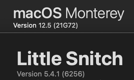

After a lot of trial and error, the issue is Little Snitch. I've reported it to the developers.
The real issue ended up being that the entire network stack of macOS is being torn down with some pseudo-connectivity. This leaves apps in a state similar to a November 2020 issue where apple's OSCP servers went down and Trustd couldn't authenticate signatures. It's a real issue that happened as reported here, wherein for an entire day, all Mac users couldn't launch apps.
Network issues became my focus when I noticed that when the issue happens, the entire Networking pane in System Preferences becomes empty with no WiFi, ethernet, or network services listed. In addition, in System Profiler, the entire WiFi pane can't list a single piece of hardware in my system. Again, this points to a low-level issue deep in the network stack of macOS where it can't even poll the network hardware to know it's there.
I found a reliable way to recreate this on a fresh macOS install:
- Install Little Snitch and enable its kext. You will see Little Snitch running as a network service in the Networking preference pane of System Preferences.
- Install Minecraft. Add a few servers to the connection window. Sometimes, they will try to load continuously and never get a reply back from the server. Try to force-quit the app, and it will hang and not really quit. The app will remain in the dock and say its unresponsive. (I think there's something specific about Java's networking code that helps reveal the issue.)
The end result will be that the network stack crashes in macOS and stays down until a reboot, and the system becomes very slow. I was able to verify that in the 2nd step, when Minecraft is waiting for the servers to reply, moving Little Snitch to the trash bin forcibly unloads its kext, and the servers *immediately* begin responding.
I think this behavior just began in 12.5. Not sure if Ventura is impacted, but I'll test it alter.

I'm not sure if it's the same issue unless you're using Little Snitch or something that intercepts network traffic as kernel / network extension. I got my issue pinpointed pretty specifically at this stage. I can reproduce this on a fresh macOS install with nothing but Little Snitch running if I run Minecraft with even just 1 server added. The server will sometimes take up to 3-5 minutes to load, or sometimes never load, but moving Little Snitch to the trash lets it load immediately. And if I force-quit Minecraft in the 3-5 minutes its stuck, the networking pane disappears and the system becomes unstable.
I will say though that I think Ventura handles the situation *slightly* better in that apps still launch normally, and I can actually shut the system down properly, even while the network stack is hosed. Monterey seems to handle it worse. Either way, the Little Snitch devs need to fix their crud.
Also: I think my issue is specifically Little Snitch + Java. Before I made the correlation that Minecraft can cause it, I realized that all the times I saw a lockup was when I was starting or stopping an app called DavMail, which is a background process that uses Java too. I think Java helps Little Snitch mess up the network stack.
