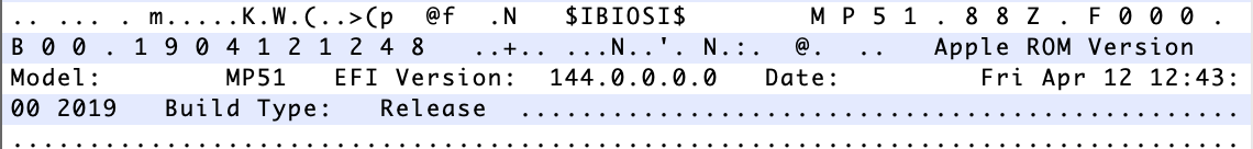

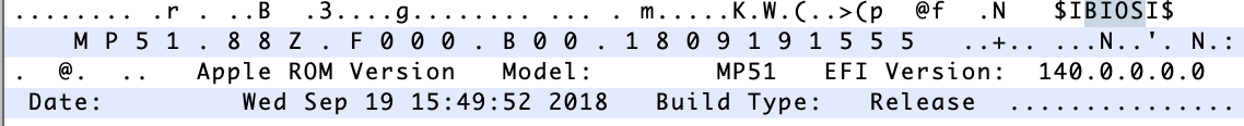

With the Matt Card plugged on, my bricked Mac boots, without a problem.
The Matt Card has a 144 Bios and the Bricked Chip had an 140 Bios on it.
Matt Card:

Bricked Chip:
