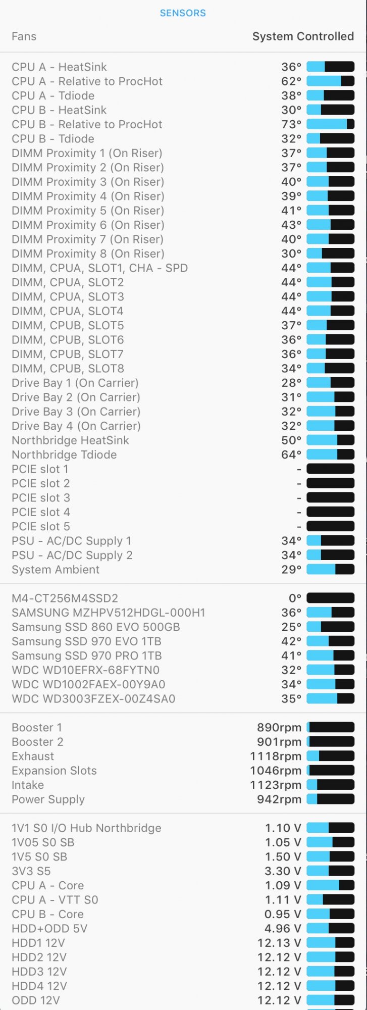

Celsius ?
[automerge]1588390163[/automerge]
My Northbridge is rock solid and steady at 63 - 64 Celsius.

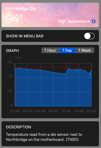

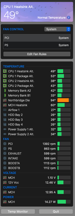

This is terrible, the northbridge heatsink makes (as expected) no contact to the northbridge.
You keep on cooking the poor thing.
Wondering how long it lasts...
Reactions: h9826790

If you sure that your heatsink is installed correctly, please check if your heatsink and northbrige are not concave or convex, this delta between your tray NB/heatsink temps don't make any sense at all and you will damage your tray really soon if this continues as is.
OK ... dual hexacore 3.06 GHz .
The Northbridge chip thermal is way too high for a System at idle .
And , it is way too high relative to its Northbridge heatsink .
The normal difference between the two is like 10 - 15 degrees C .
Yours are at 34 degree C difference .
Obviously , your Northbridge heatsink is not properly attached , there is failing TIM on the Northbridge die , or both .
Your Mac is unhealthy to use and you need to address this .
To place things in perspective , I've built Nehalem cMPs where the Northbridge Chip runs at 65 degree C while every major System component operates at full 100 % load . These Systems tend to last for years while being heavily used .
