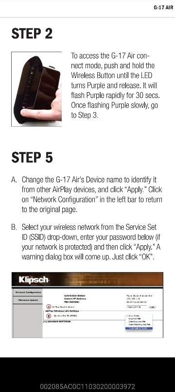

After looking at the manual for the G-17 Air, it seems there is way to check for firmware update in the web interface. Have you tried that already?
I have, and have updated it to the latest FW. No difference.
