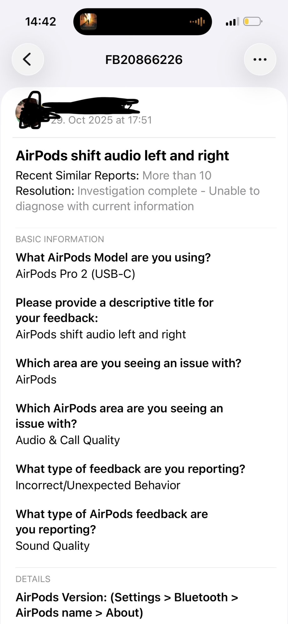

For about a year now I’ve had issues with my AirPods Pro 2 (3 pairs in total), where the audio shifts from center to the left or right, sometimes randomly.
There have been many reports over the years of users who’s AirPods Pro 2 became affected by this and similar conditions.
More details on my specific problem (you may skip):
  • This only happens with either a Listening Mode or Spatial Stereo or both enabled, never with the „Off Listening Mode“ and Spatial Stereo turned off.
  • Headphone Accommodations don’t affect this issue, how it happens or when it happens (I have Headphone Accommodations tuned for „Balanced Tone“ and set it to „Slight“ as this removes perceived dampness of the original AirPod Pro 2 sound while adding detail in the mids and highs)
  • It feels like the seal is suddenly not good on either side and using Head Tracked Spatial Stereo at the same time as if you’re (sometimes slightly) turning your head.
  • I do not ever use Head Tracked Spatial Audio.
  • This effect may switch sides at any point or only happen on either one.
  • This happens mostly in public transit vehicles at higher speeds or during strong winds. It seems linked to changing air pressure around (me,) the listener, but can occasionally happen while walking or moving one’s head.
  • Eventually, the sound will return to the center, it doesn’t stay on either side for longer than 10 seconds at a time.
After having noticed the same behavior on 3 separat units (all still in use, genuine and updated to the then respective latest version (all this started with my first pair in January 2025)
I decided to bite the bullet with one pair and turn on Beta Updates and Analytics Data (something always turning off itself after an iOS beta update… for me) and report on said issue.
What I didn’t expect was to see that there have been other reports about it and that an investigation was launched.
Unfortunately, that investigation apparently won’t lead to a fix… according to the info provided by Apple themselves, which seems very odd.
I mean, I’m 1. glad other people reported the issue too (not so much that they encounter a similar problem) and 2. happy it’s on Apple‘s radar, but to read that the issue can’t be isolated and no fix will be issued feels weird.
Does that mean they can’t fix it? It is, according to my observations, a software issue only present when at least one of the two major sound processing options (Listening Mode and Spatial Stereo) are in use, and to me it seems like there could be an algorithm making sure the sound stays centered, even when the pressure is changing around the ears, but apparently not? I mean, the AirPods obviously react to something, but that something can’t be pin pointed? That’s unexpected.

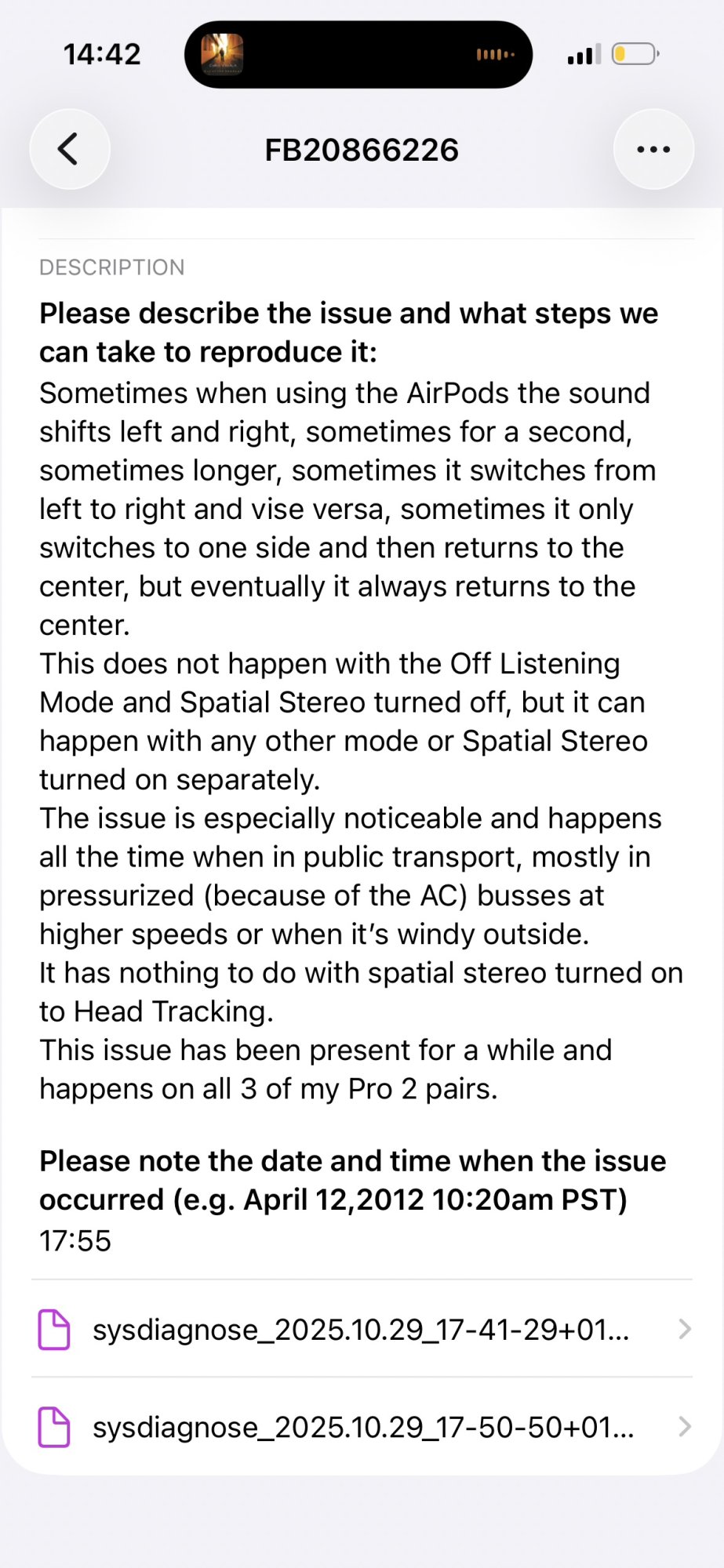

By the way, here is my explanation of the issue in the report itself, for anyone interested.
Anyway. I just wanted this to be available to anyone scouring the web for reports of other people experiencing this issue.
