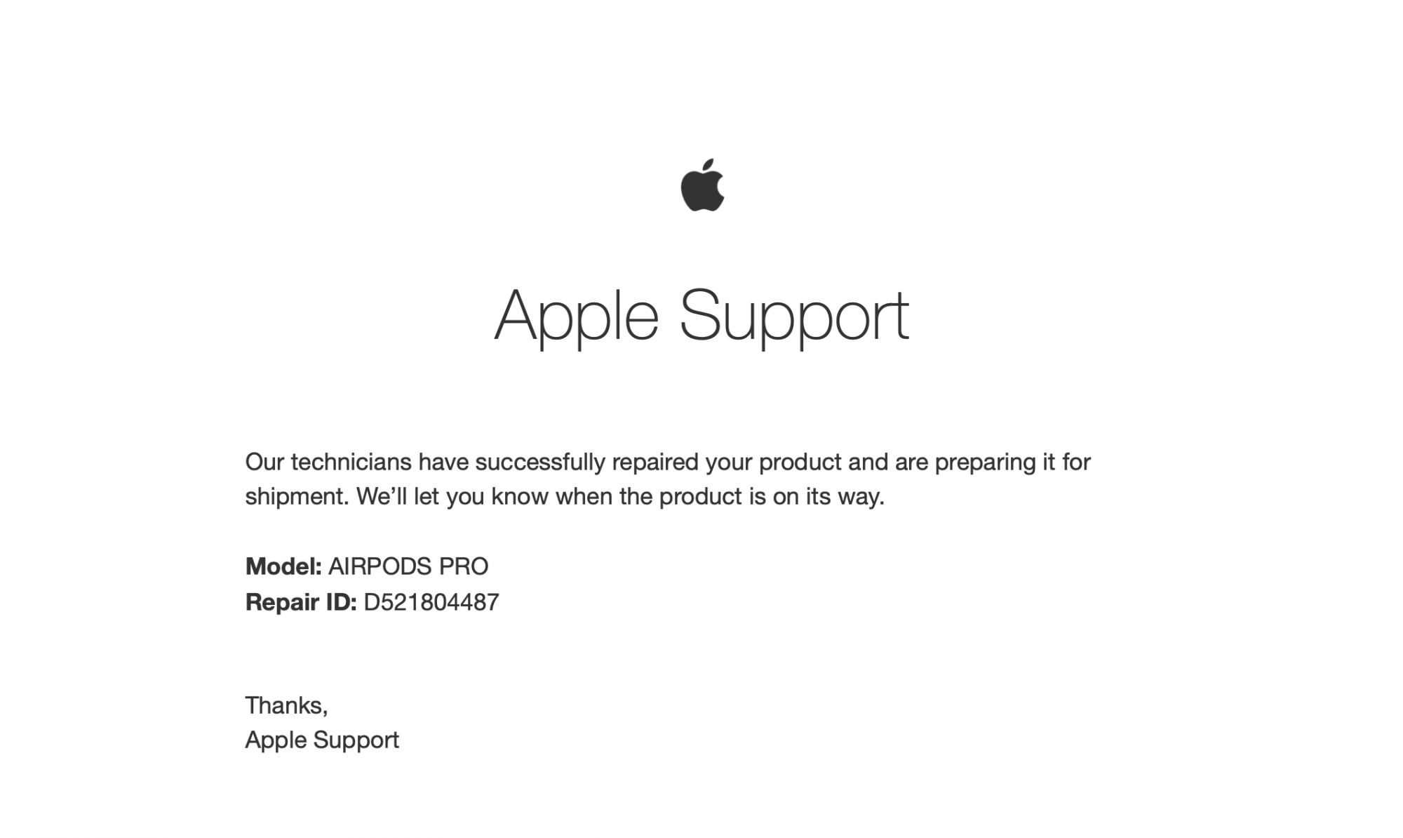

Just checked the email and this is all it says, doesn't give any more info when you log in either. I could contact them i guess though.
Nope nothing further apart from an email saying they’d been despatched. This is going back to January too so not expecting anything now
