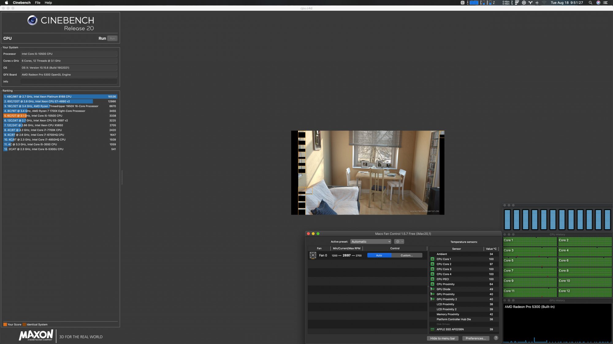

Macs Fan Control reports CPU cores 1, 2, and 4 at only 100º C, which seems way more normal. Well, normal for an iMac. That's still uncomfortably high, but at least not meltdown-level high.
Those numbers are 100% incorrect. Intel CPUs have a thermal shutdown point to protect themselves. I'm not quite certain what that trip temperature is but it is somewhere in the vicinity of 100°C. Fanny is simply not compatible with the 2020 iMac and its 10th gen CPUs yet.
That's reassuring. I noticed some software like iStat haven't yet been updated to support this iMac. Fanny shows temperatures, but it sounds like they're just incorrectly reading sensor data.
But this is still terrible news. 100°C is too much, even though considered "ok" for Macs. But what's really bad is the reported fan speed in your screenshot. That's full speed! Way too noisy. I wonder what the CPU frequencies are. Please try Intel Power Gadget. Can someone with the i7 10700K also report on fan speed and CPU temperatures?

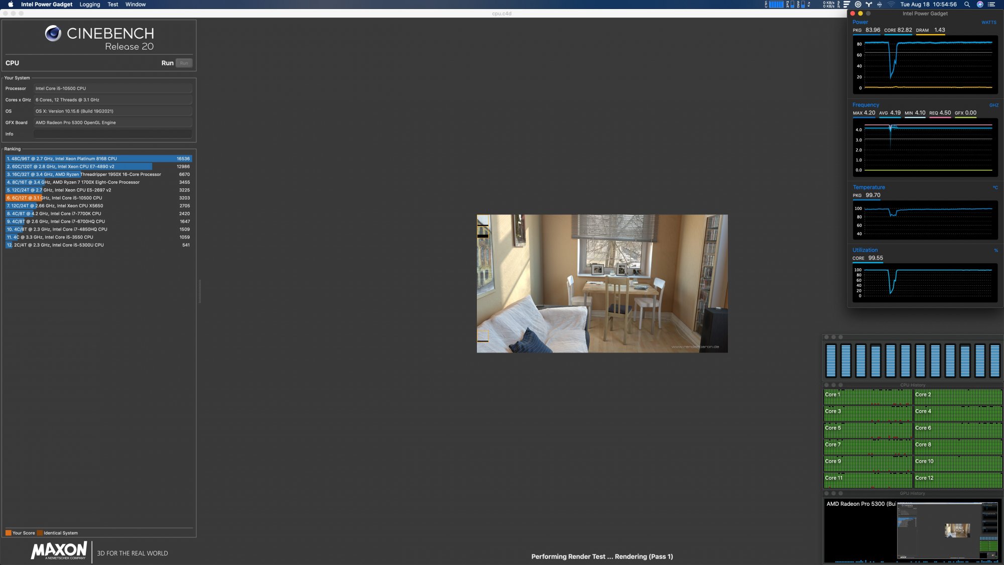

Only 99.7º C in Intel Power Gadget. I'd also like to see some readings from others with the 2020 27" iMac.
I take the first graph to be CPU power. Seems to be running at 80W constantly, above the nominal 65W TDP rating.
So actually that's "ok": runs at 4,2Ghz well above base frequency (3,3Ghz). 2700rpm would be too much noisy for me, but at least you get some good CPU speed in return and it seems to be holding that frequency despite high temperatures.
