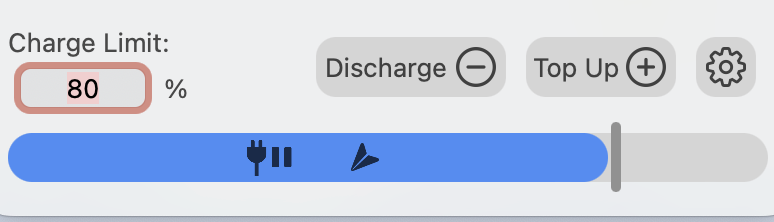

I have tried just about everything, and it does not seem AlDente Sailing Mode works on my M1 MacBook Pro 16". It works fine on a 2019 MacBook Pro (Intel). As you can see in the picture, I *think* this is the way it should look when it's in Sailing mode, I have the limit set to 80%, the sail mode lower limit is 70%. On my Intel Mac, the battery drifts down to 70%, as I think it should. But on the M1 Mac, it stays at 80% or 79% all the time. The only setting I think I have changed is enabling Hardware battery percentage.
I have reinstalled the Helper application, and I unplugged from power and let it go to 60%, as I read that sometimes gets it going for some users. But it went up to 80%, as it should but just stays pegged there, probably doing a bunch a little charges, instead of drifting down to 70% and then charging as Sailing Mode is supposed to.
Any thoughts? Is this working for anyone on an M1?
