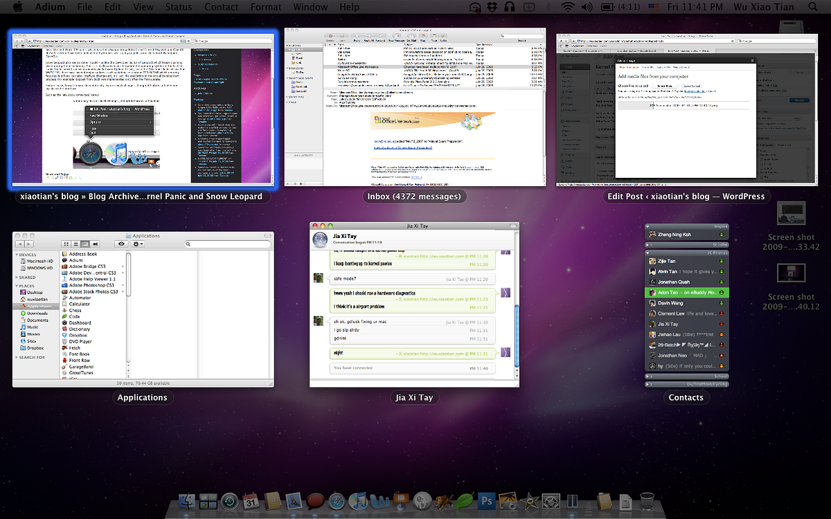

Actually it´s not because macOS is "bad". They decided to entirely change Mac OSX desktop and spaces management to "this" with Lion, when they switched from Spaces+expose to Mission Control. It was not like this under Tiger, Leopard,. Snow Leopard… Multiple monitors /spaces in Mac worked much better then and it was waaaaaay better than Windows. There was no menubar in the second monitor at all. Spaces were just fine. You could get third party apps if you wanted more complex features. Not much needed, though. But I have used Snow Leopard until not m,uch ago and how they screwed multiple monitors and spaces was one of the reasons.
So why they decided to make it more complicated and (for many) worse? New features trying to get full screen apps better. Paradoxically, as a nod to Windows switchers…:(
I haven´t tried it but maybe TotalFinder could help you recreate a better desktop/spaces solution.
