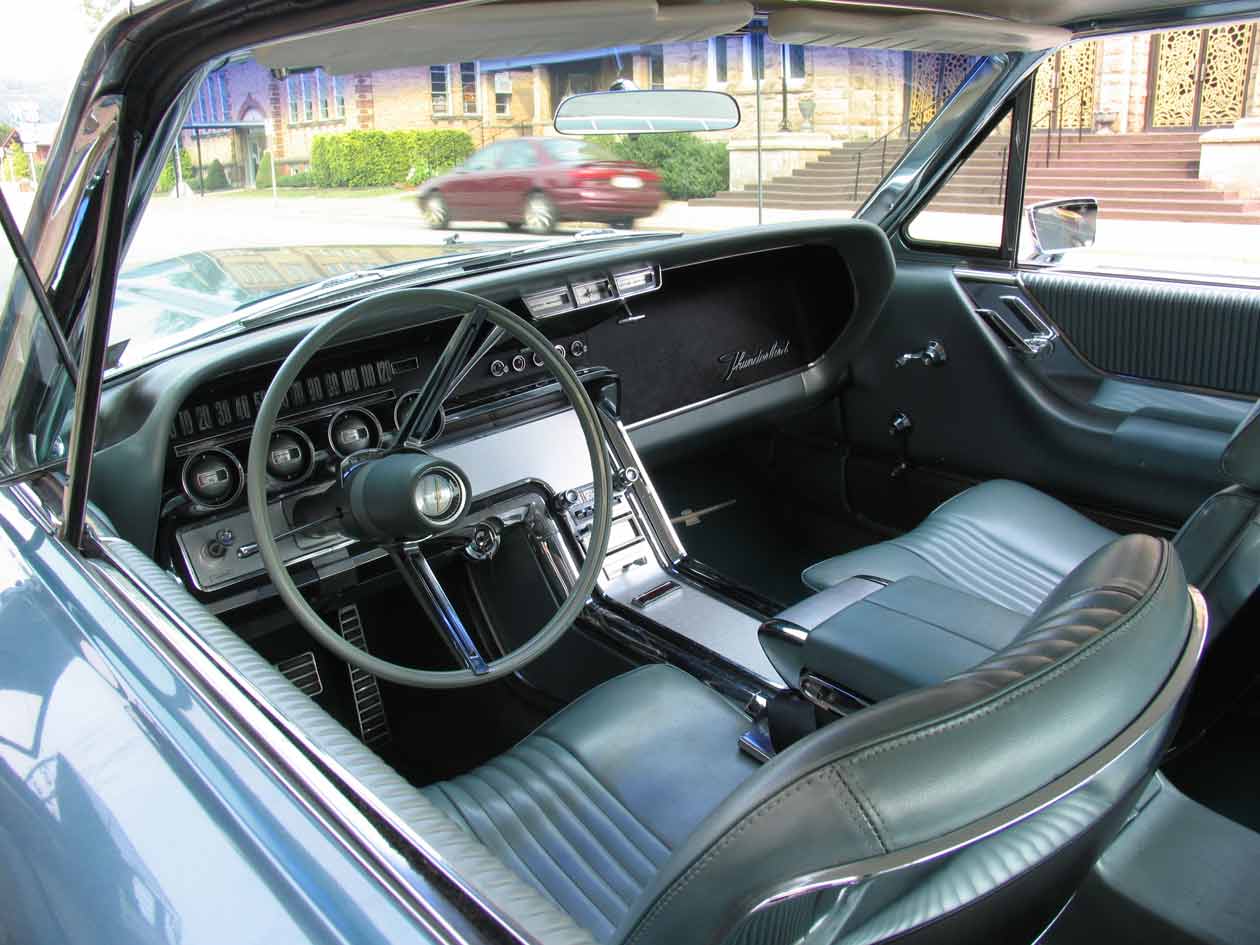

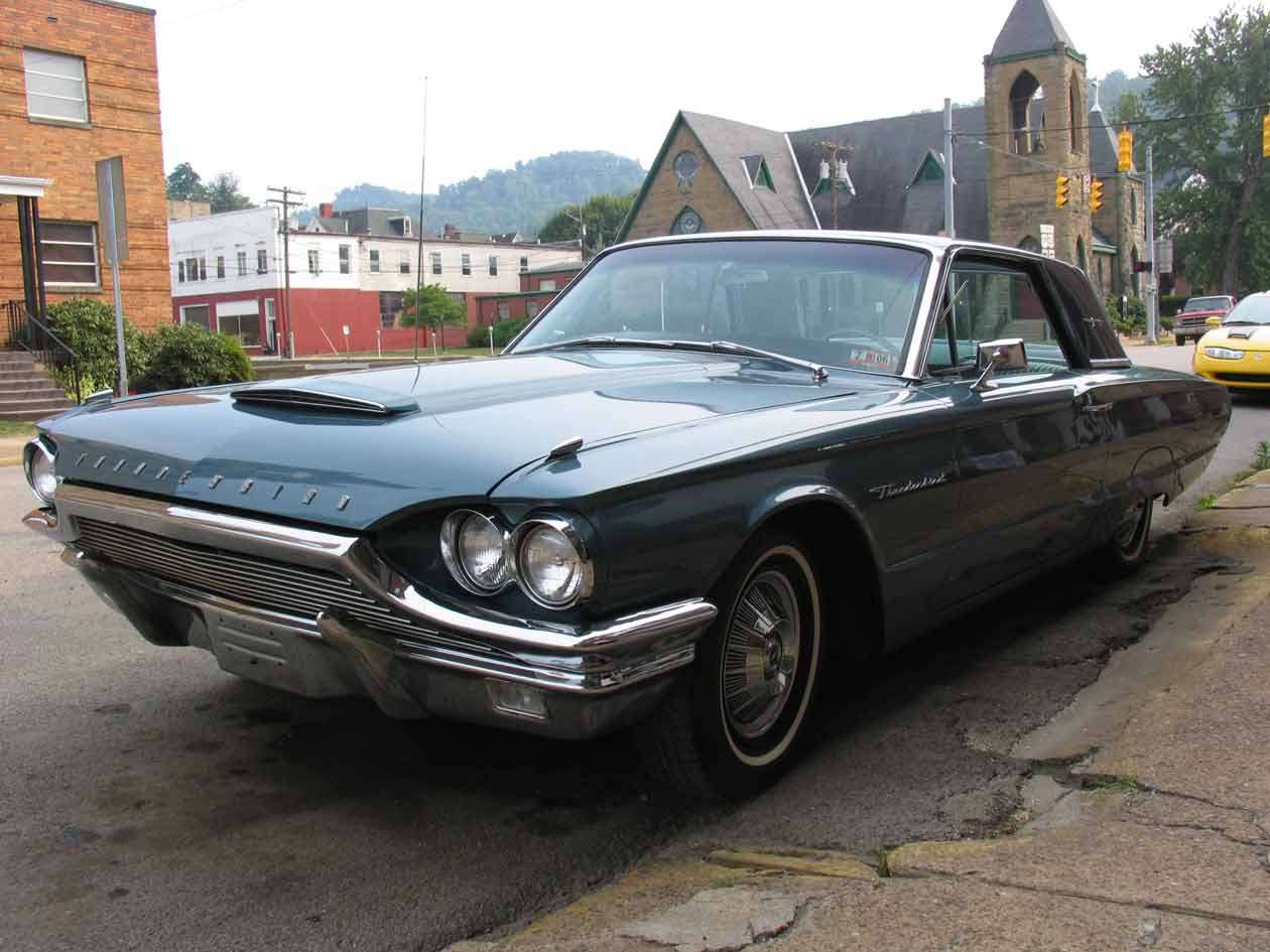

Alright this may not be an option but if anyone has any advice it would be greatly appreciated. I just bought a new (old) car. It's a 1964 Ford Thunderbird (see below). It's in beautiful shape, all original, only 38,000 original miles. It has the stock 1964 AM radio (they didn't want to spend the extra $44 to get the FM option) so I'm wondering if there are any AM transmitters out there. I've found loads of FM transmitters. I really don't want to start taking original parts out of the car but I would like to be able to listen to the iPod if possible. Let me know what you think.
Thanks,
rk

Thanks everybody for your help and suggestions. Tape is not an option, Taeclee was right the 8 Track tape player was first offered as an option in '66. There was a AM/FM radio option that would solve my problem but I'm not having any luck finding one anywhere (plus the thought of ripping the dashboard apart to get it in doesn't sit too well). I'm going to look into the AM transmitter that was suggested by joecool. It'll work if it's battery operated and has an input that can be adapted to the iPod. Thanks for all your help. I welcome any and all other suggestions.
rk
