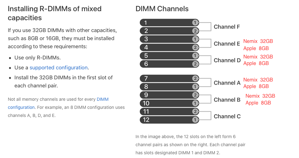

I've 4 new Nemix 32GB 2933MHz DDR4 R-DIMMs and apple's site https://support.apple.com/en-us/HT210103 states that you can mix capacities as long as they're the same spec.

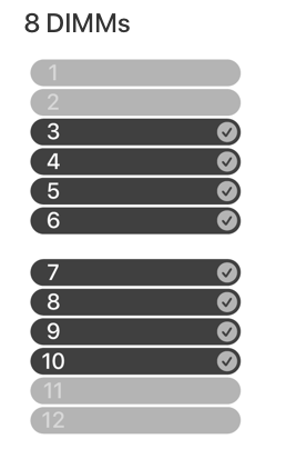

So Apple state "Install the 32GB DIMMs in the first slot of each channel pair.....

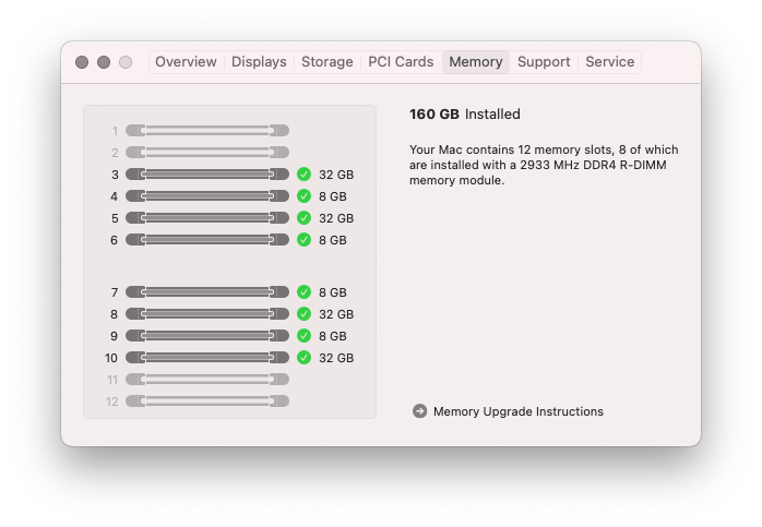

The above layout I added was incorrect, sorry. It's
Seems to work fine but the question still remains. Is there some sort of significant performance penalty?

At a glance, I believe you have your DIMMs in the optimal configuration. And to the basic question, it's pretty simple: With six channels of which you're using four, you'll get 4/6 or 2/3, 67% memory bandwidth. The biggest thing to avoid is 2/6 utilization, at 33% usable bandwidth. 4/6 is a 100% improvement over 2/6, 6/6 is only a 50% improvement over 4/6, so you're doing OK.
Recognize that CPUs avoid going to memory when they can, so 67% memory bandwidth doesn't mean you'll get 67% performance. It's not ideal, but fine till you pick up another couple of DIMMs in the future.
