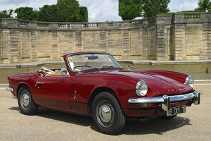

Hector said:
i'd like to get one when i'm 22ish, cant quite afford to get a spitfire and a bus, though it would be obscenely cool.
A spitfire as in the WW2 plane?!
Though I would actually like a ww2 one, I want to get a pilot license as soon as I've got my car one.
