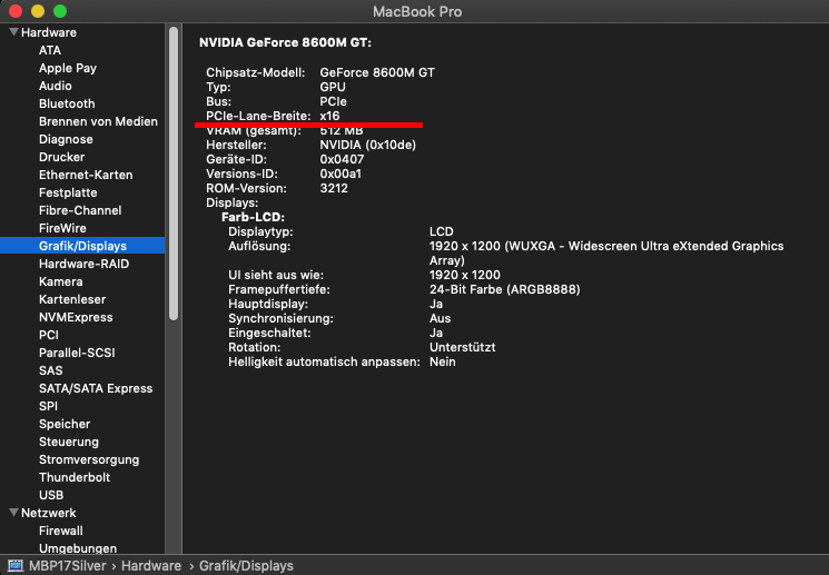

As a temporary fix you can remove the logic-board and apply mild heat (140°C for 10 minutes).
Be sure to remove all plastic parts, that could melt (like the two plastic-clips at the back-end of the board)
(Never ever go for nonsense like reflowing or reballing, since the problem isn't a problem of the BGA-soldering-connections between the GPU-chip and the logic board. It's a problem within the GPU-chip, that tends to be mended by applying well tempered heat of 140°C for 10 minutes - a temperature that is securely below melting point of solder and below boiling point of flux.)
You'll need good thermal-paste for reassembling.
All procedures will take about 2-3hs.
After applying mild heat to recover the GPU, the PCIe-Lane-width will be back at x16. You may check the PCIe-Lane-width regularly after the "repair-fix": if it's going down below the x16, then the GPU is about to fail again.
After the fix you'll have to take care, that the device/GPU does not overheat again (aluminum-stand, fan-control).
Replacing the GPU is the only permanent repair, but will cost about 100-150 bucks. PCIe-Lane.png
