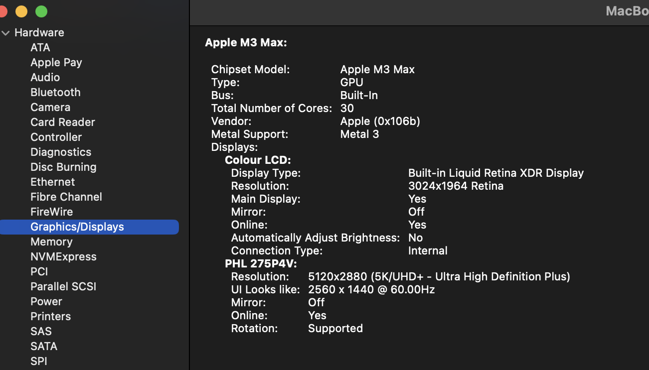

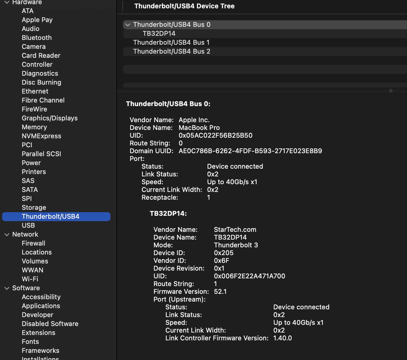

working on on 14" m3 max , with startech TB32DP14 on thunderbolt. brightness control works using the MonitorControl app.
