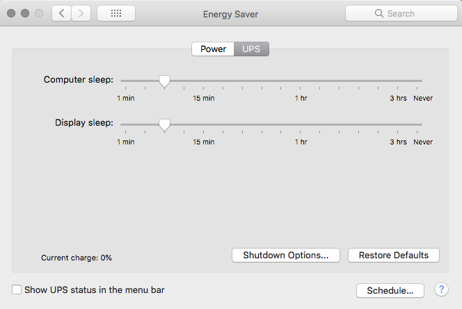

Anyone here with an APC UPS plugged directly into their machines ever had issues with it reporting 0% charge on a reboot, and requiring an unplug & replug of the USB cable to correctly report the charge? It's showing up as connected, just 0% charge. Cold boot doesnt see to cause the issue, just reboots. Sleep doesn't clear the problem.
Is there some way to manually tickle the USB connection to force a re-polling of the device?

No, I mean USB - as in the UPS has a USB cable to my Mac, which communicates the battery charge and mains power status. I'm trying to figure out if there's a way to make the USB port force a re-polling of the device, to mimic the behaviour of physically unplugging and replugging it. That way, I could set it as a script to run after (re)boot.

Thanks, I'll check it out when they get back to me and see what they say - I can eliminate re-enumerating the USB port on the Mac as a solution using USB Prober.app. I was hoping that would work:
Code:
/Applications/Utilities/USB\ Prober.app/Contents/Resources/reenumerate -v 0x051d,0x0003
...but sadly it doesn't produce a change in the reported 0% battery level. I know if I physically unplug, and replug the USB cable from the Mac, or from the UPS, it'll do what is necessary, but perhaps as you suggest, it's something I can change on the UPS itself.

Just the Energy prefpane. It's done this since the device was new - originally it was connected to a hub, which was on the end of a (correctly specified) 5 meter USB cable. So I assumed the topography of that was the issue. Then I bought a second long cable, and plugged the UPS directly to the workstation, and the problem remains.
The UPS self-tests regularly, manually self testing doesn't change the situation, but an unplug, replug is a sure fix or the issue.

The unit's been in service for almost 2 years, and there's been multiple power outages in that time - it always works correctly in terms of providing power support, but this reported levels after reboot has been a thing since new.
If all with the UPS and battery is fine, rule out Monterey (and maybe BigSur) by hooking it up to an older Mac or PC too. I'm convinced that Big Sur-Monterey has USB bugs and this might be another example of that. If you have an Intel-based computer or can get a friend to bring one over, check the UPS hooked to one of those too. If it is good there (indicator shows battery is towards 100% charge, etc), that shifts issues back towards Silicon/Monterey (and maybe Big Sur too).
It's a High Sierra system - literally all I have to do is physically unplug the USB cable, wait a few seconds, plug it back in and then toggle the "show UPS Status in menubar" checkbox a couple of times, and it'll show the full charge again.

Yup, really my only concern is that if it's not reporting the UPS charge and runtime correctly, then the system can't handle the auto-shutdown procedure.
Unfortunately, if it turns out to be a Mac compatibility issue/USB bug, you are basically at the mercy of waiting on Apple to debug the OS (or possibly a firmware update to the UPS). I'm there with you as perfectly-functional USB hardware on my Intel Macs running macOS BEFORE Big Sur won't work reliably with my Studio Ultra running Monterey. For me, this is generally "unexpected ejections" of USB connected hard drives. I wonder if you are basically seeing "unexpected ejections" of the UPS, resulting in pref pane information showing 0% as if there is no UPS there at all.
No, it's showing as connected, but with 0% charge:
You don't see the UPS panel if it doesn't detect the UPS as connected.

My concern is primarily if the power goes while I'm out of the house, I want the gear, and drives to shut down gracefully.
I'l have to see if it's possible to plug it in via Ethernet, if USB is just flakey in the UPS' firmware.

I would have thought being plugged into a powered hub directly, which was then upstream via a 5m cable to the Mac would largely replicate an active cable. The Mac can still see the UPS, it knows it's connected, it's just reading a zero charge from it. I'll see what APC's support folks think.

Problem's manifested with 2 different 5m USB cables - one a Passive/Active Male -> Female cable that the hub was plugged into, the other a Male -> Male cable plugged directly to the Mac.
If you have any easy way to test the 2-year-old battery, that might be worth it too. I just had a UPS showing 100% capacity. In power blinks, it would immediately conk like the battery was dead, showing "overload" on the front panel. It would take unplugging everything from it to get it to work again, then plug one thing in at a time. Again, it would report 100% battery. Next power blink, same issue. After trying a variety of things revolving around "overload" cause possibilities, I finally changed the battery as last resort. No problems since. Old battery reported 100%. New battery reports 100%. But now in power outages, it works as expected.
It's works as expected during outages, and passes all its self-tests *shrug*.

Yeah, the firmware in the UPS is where I was thinking the problem might be located - I haven't checked it yet, but it's on the list once I hear back from APC.

The hub was my thoughts for the original culprit, but I'm in the process of getting another machine that can be moved closer to the UPS to test the theory of a shorter cable. Not that a shorter cable is a solution, as the UPS lives in a cupboard with the power points and a bunch of gear, and the Mac is out in the room.
