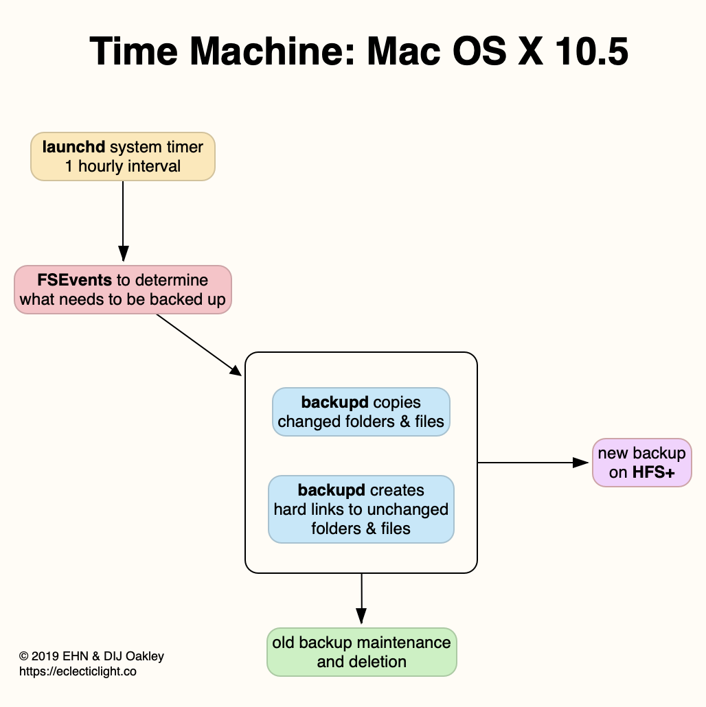

Time Machine to APFS uses the built in snapshot feature, which is faster and more robust. Time Machine to HFS+ uses directories and hard links, which is more prone to fragmentation.

Believe it's no longer an option for HFS+ for new Time Machine disks, TM will erase what's there and reformat as APFS. So no choice there.
