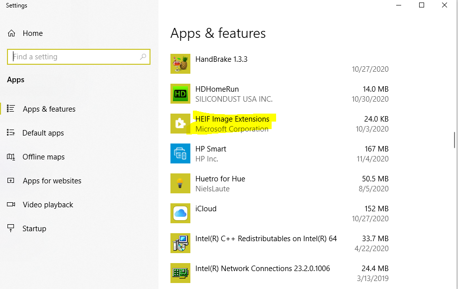

Windows 10 does indeed now natively support HEIC as of the 20H1 release. To see if you have it installed on your machine you can go to Settings > Apps and Features and it should appear in the listed apps:
For versions of Windows 10 down to version 1809 the HEIC extension can be found in the Microsoft Store: https://www.microsoft.com/en-us/p/heif-image-extensions/9pmmsr1cgpwg?activetab=pivot:overviewtab
There is no native or plugin support for earlier versions of Windows, including 7 and 8/8.1. In this case you can use things like Dropbox or File Viewer Plus to open them.
