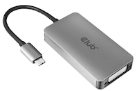

My 30" ACD connects with a male Dual Link DVI into this USB-C adaptor (plus a 2nd small adaptor for the USB cable).
Club 3D CAC-1510-A USB C to Dual Link DVI-D Adapter HDCP Off for Apple Cinema Displays
In my case the ACD must be powered on before the 2021 MacBook Pro, otherwise it cuts in and out, so I'm still not 100% sold on it. When it works it's great. I occasionally have to adjust the ACD to max brightness at startup via the side panel buttons.

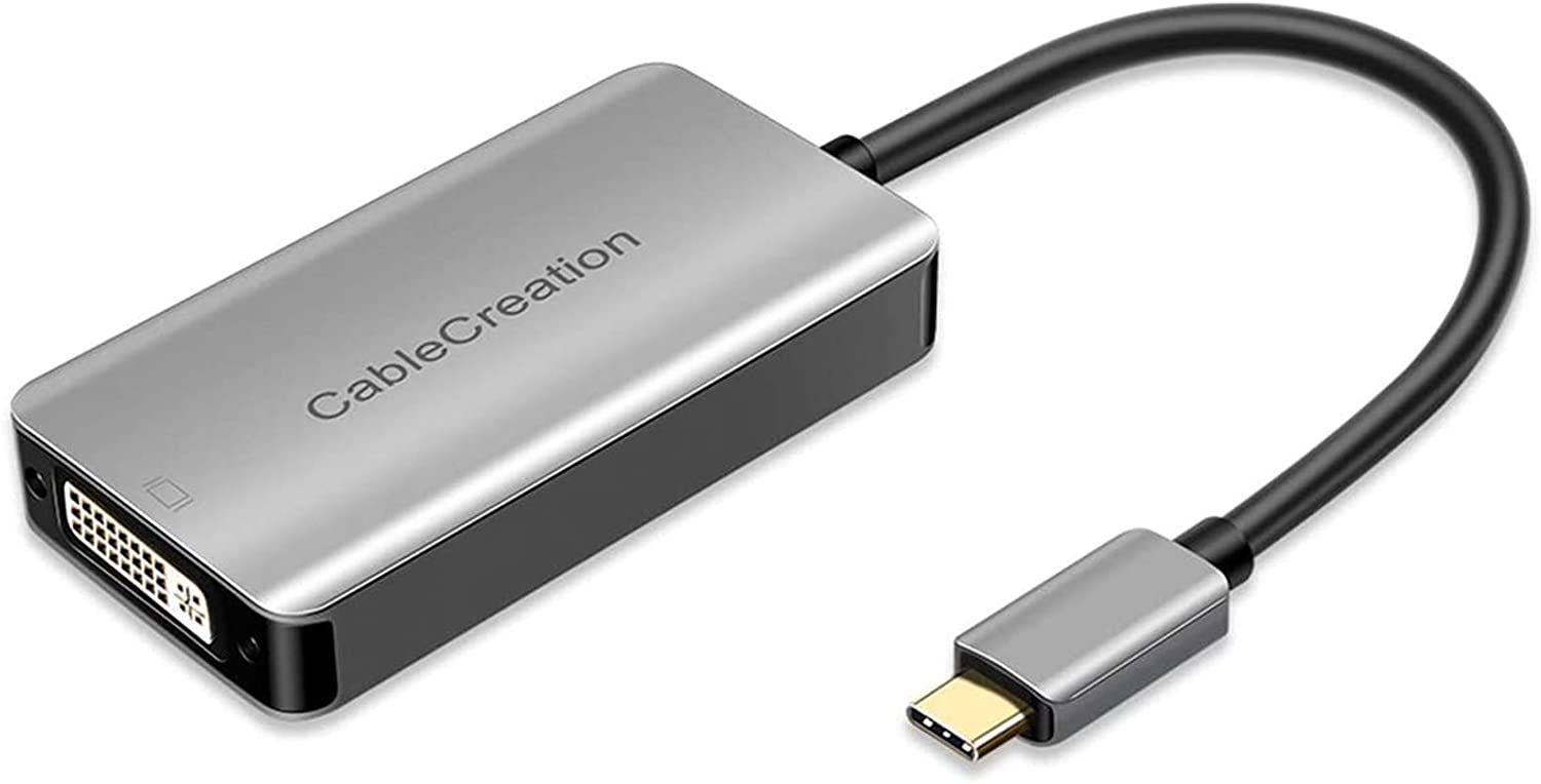

I have a Cable Creation one that looks identical. It works fine with Intel Macs, but I haven't tried an Apple Silicon Mac (because I don't own an AS Mac). I bought the Cable Creation one simply because it was cheaper.
