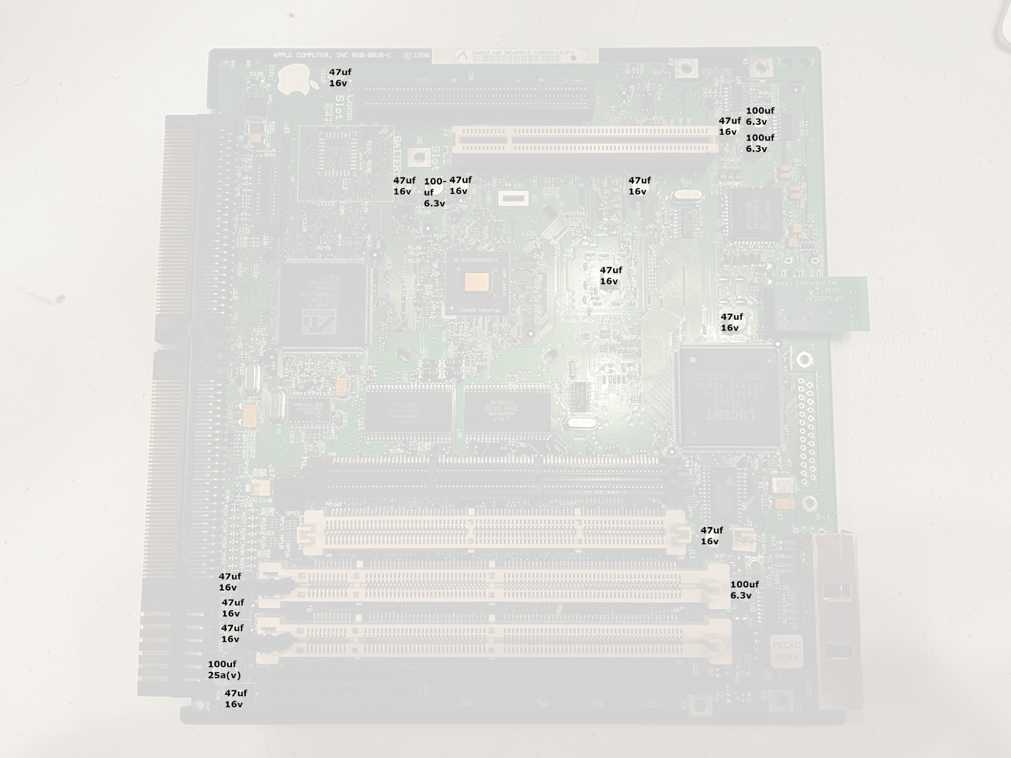

*Whew* now, all that being said, my question is: could replacing an electrolytic capacitor with a tantalum equivalent somehow impact the clock speed, which the ADB controller relies on to interpret keystroke pulses? Also, does anyone have a technical paper, or equivalent that discusses the TAM's logic board in detail? Preferably, the paper would identify sections of the board where various functions are performed. In the attached image (which I created, inspired by Bruce of "recapamac.com.au"), the lower-right section is where the ADB and serial ports are located (ADB is the bottom-most port).
If the TAM's logic board is set up in...logical sections, then I would hypothesize that both or either the 47uf and 100uf caps are part of the ADB circuit.

The photo in question. All focus is on the bottom-right corner.
