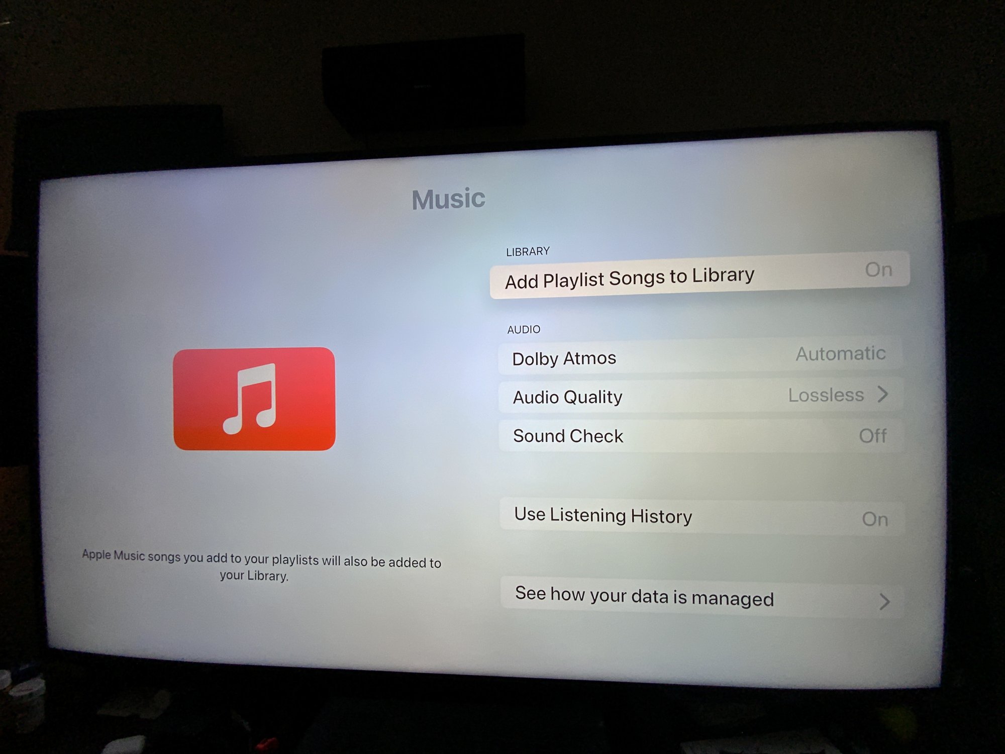

You have to enable it through the Setting>Apps<Music<Dolby Atmos/Lossless setting.
It’s a totally different setting.

Yes, I am under that menu. I restarted the device, did not help. Updates are set to Auto.
