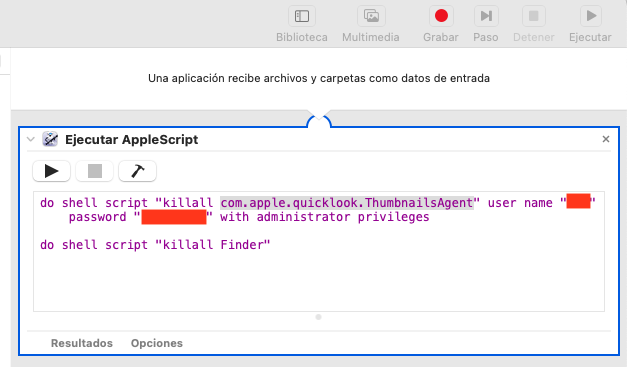

Hi, I'm looking to close com.apple.quicklook.ThumbnailsAgent which looks to need admin privileges, I'm using this script in automator in order to reset the preview icons that aren't working time to time in Finder (Monterey):
Code:
do shell script "killall com.apple.quicklook.ThumbnailsAgent" user name "****" password "********" with administrator privileges
do shell script "killall Finder"
2ed6e1fb-28d8-4814-9b9f-9d99dc216c3d
It worked the first time I tried, it wont now....
Finder reboots but the process still in Activity monitor , you can see the process won't quit (same PID).
No error message...
I tried with a delay 10 between but that doesnt makes any sense (and dont work either)
bogdanw
macrumors 603
Mar 10, 2009
6,144
3,042
Try
Code:
do shell script "launchctl kickstart -k gui/501/com.apple.quicklook.ThumbnailsAgent" user name "***" password "***" with administrator privileges
