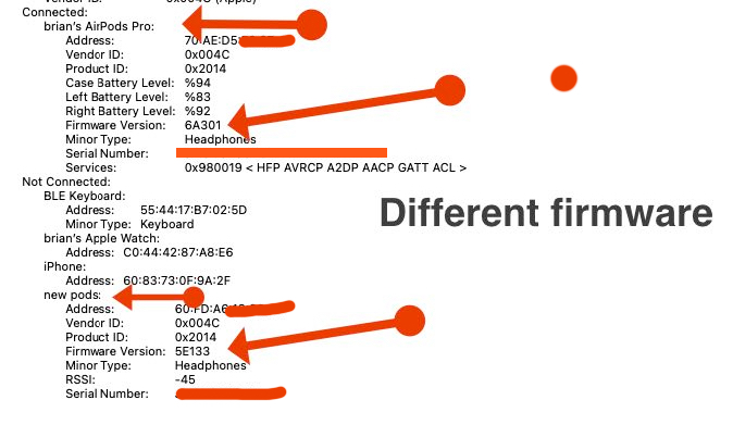

After just over an hour I opened the case and no response from phone .. went online followed the procedure for replacing lost airpod still nothing ..
Quick search online and noted each Airpod must be matching in firmware(makes sense this is critical)..the new left one(replacement was on old firmware 5e311 old one original 6a301).

been through all procedures numerous times. it is currently at apple service and a call from the engineer on Friday he conceded not possible to update the single airpod if the other is not matching in firmware(his words) so the issue was taken to another level as it is not his decision on issuing replacements for a lost airpod scenario .to be honest I went out and purchased another pair was tired of the numerous excuses and waiting for a call for the next scenario /procedure.. too much misinformation from one staff to another all seem to interpret there own understanding.. if I get em back and fully working as a pair Ill just stick em in the draw for a rainy day.. thanks for the advice anyway...
update 29 October finally offered a refund ... 3 weeks later ..not possible to pair/update firmware where replacement does not match existing Airpod 2 pro in FIRMWARE .. this is from Apple service dept ..no other info/solution provided..
so be aware if you lose your Airpod pro 2 (note pro 2 !! not original pro generation ! ) you may hit a a very inconvenient brick wall when following any provided procedure its generally not a problem for replacement Airpod providing the firmware is identical.. So check the firmware prior to purchasing / leaving store .
