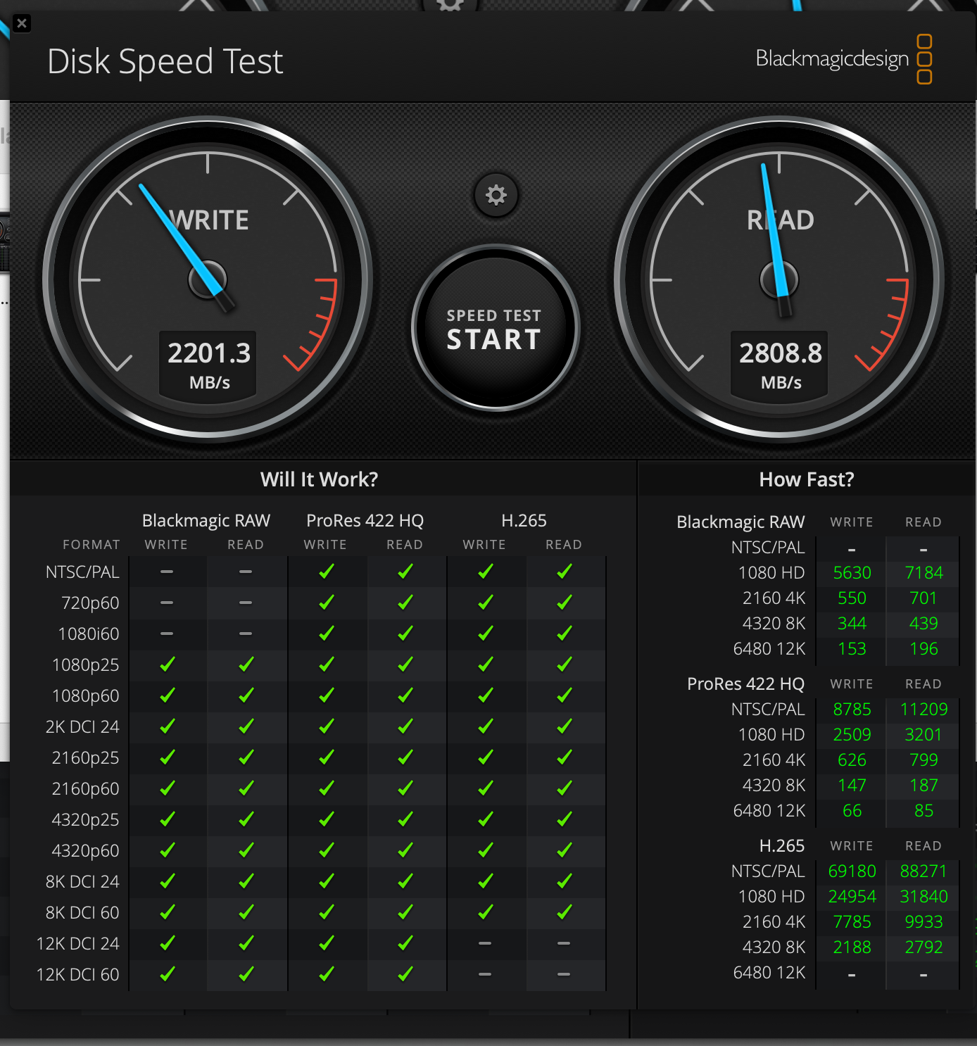

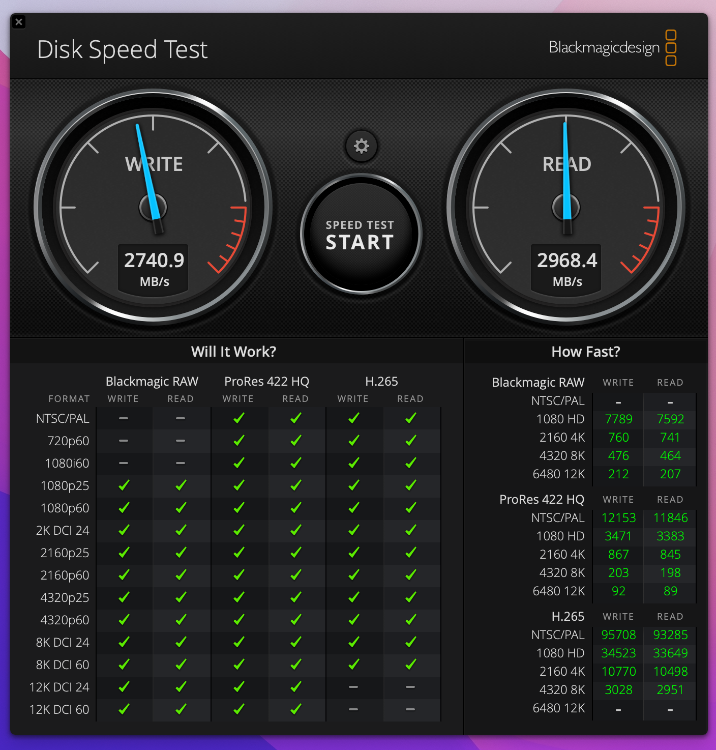

I have ten internal SSDs in my NcMp 7,1. Only four of them are recognized as internal, one is the OEM Apple SSD and the other three are 2½ form factor mounted in an internal cage. The other six are blade SSDs on two PCIe cards. Four of the Samsung Blades have OSs installed and are bootable.
In September I ran a speed test of the OEM SSD and one of my Blades:
I have two PCIe SSD cards. An IOCreast card with two SSDs and a HighPoint SSD7103 with four SSDs (3 970 EVOs and 1 970 PRO) My Boot drive is on the 970 Pro on the HighPoint. I don't use my T2 drove for anything other as a backup in case of catastrophic failure. Both of my SSD cards were originally mounted in my cMP 5,1. I don't run these as a raid.
Below are the speeds recorded in BlackMagic Speed Test. The first is the 970 Pro on the Highpoint. The second is the T2 Drive:
Lou
